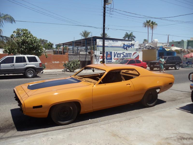

Just painted '72 SSP and I have not re-installed any of the glass yet (I removed all of it: windshield, side windows, backlight). I would like to postpone working on the interior, but I thought I read somewhere that for certain models it is recommended to replace the headliner before replacing the glass. Is that true for the 71-74 B bodies? Thank you.

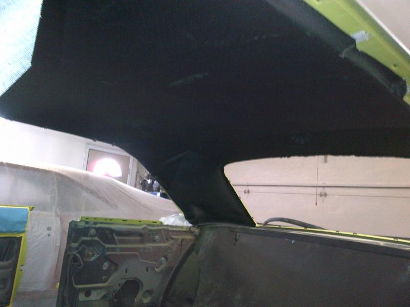

I just put in 2 headliners,not the same year as yours,but I was very thankful there was no glass in the car. I spent some time sitting on the speaker shelf pulling on the headliner. I love those cars in that color! I seen one once with orange seats!

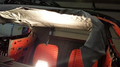

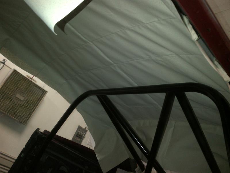

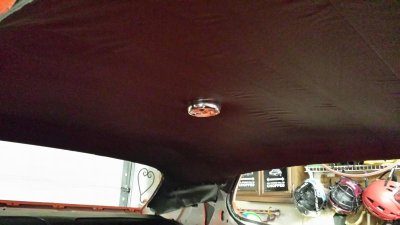

Save yourself a bunch of headaches.... install the headliner before windshield and backlight.20141127_083529.jpg20141128_160515.jpg
Also , another little tip.
install the visor, dome light, coat hook, ect , screws in their holes leaving them just a few threads out from flush.
after the liner is in and tight, its easy to locate them and each exact spot the hole goes for them.
allways get the C pillars straight and correct 1st before gluing the rest.
