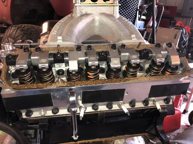

I run the E Street 75cc heads
Yes they have angled plugs , I run the HP factory exhaust manifolds with zero issues on plug clearance
200psi cold cranking compression all eight with my 383/432 Stroker - 440 source
Comp XE 275HL Cam and Lifters
Had my machine shop go thru the heads before I installed them myself - He had zero issues
One summer , so far so great
75cc Estreet = angle plugs
84cc Estreet = straight plugs
No need to replace any hardware on the Estreets, as long as the springs are suitable for the cam choice.
