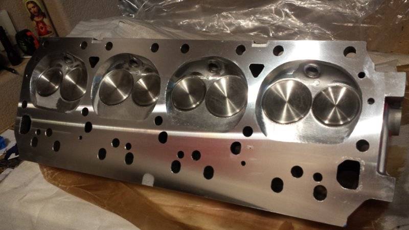

I recently got them back from MCH where they were cnc ported, they now flow an honest 300 cfm at .550" lift. 80 cc chambers, straight spark plug, standard valve train and price were key points why I chose them.

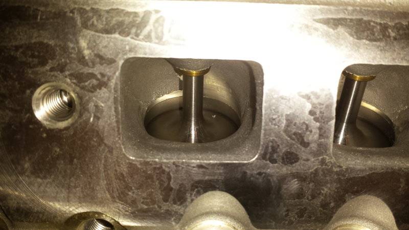

Before porting...

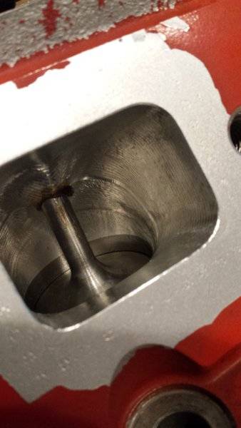

After porting...
Nice blend work..I'm guessing g there's more than just carbon in the before...little bit of casting flash?

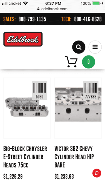

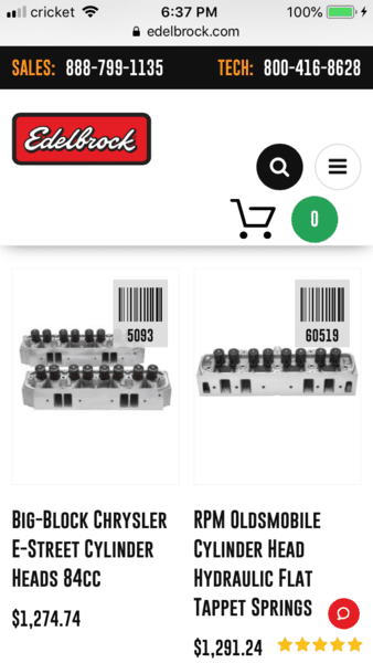

Granted, the Ebrock online catalog search feature is as weak and useless as they come....... nonetheless I was able to find all the familiar BB Mopar RPM and E Street part numbers that have always been available.
Estreets are also shown as “ships today” on the Summit site.
Accessed from the provided link:
0554439D-2B05-4F3A-9D81-5072F49AF0E4.png F8BAF063-2884-48AC-940A-0040CF811B1B.png
Also, a “fwiw”...... and no idea if this is going to be what they come with from now on, or if it was a screw up, or they were out of the other ones....... but I just went through a set of 84cc Estreets about a month ago...... and that set had the ductile seats like what are in the RPM heads, not the powdered metal seats.
My point was simply that the E Streets for BB Mopar are still listed in the catalog, when it was stated by “jeepthrills01” they weren’t.
The first pic is before the heads were even ran, not sure about what you mean about carbon in the before. Casting flash is the wrong terminology , more like parting like like you see in all cast parts. You can zoom in on the first pic and see one of the lines. They are still very smooth in the ports ootb. Transition in the bowl were ok, I blended them before I mounted them originally.
