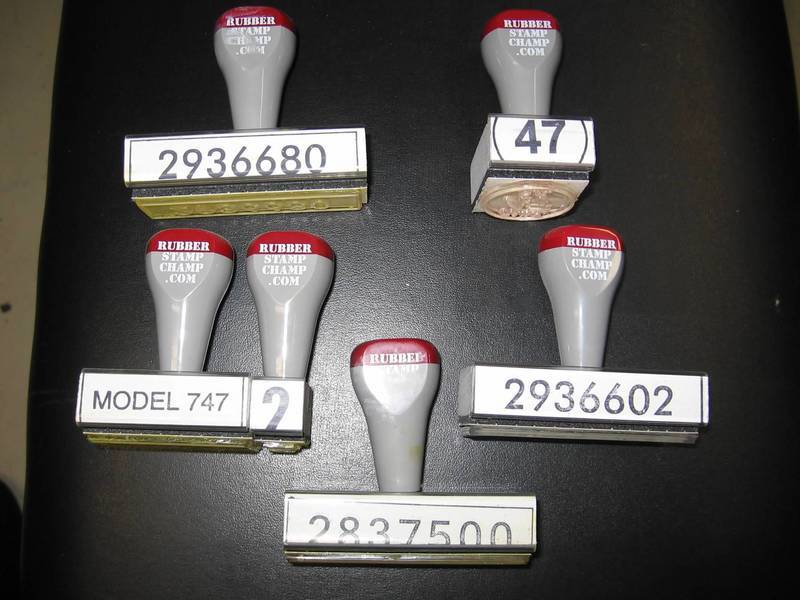

i had to message the guy from ebay. he was using my pics to advertise his product. that did not sit right with me.Nice man, I ended up buying a stamp from that dude on eBay. Maybe I’ll rent it out to make some money back. Lol

Yea I was thinking the 600 range as well. Do you use a medium yellow for the stamp?

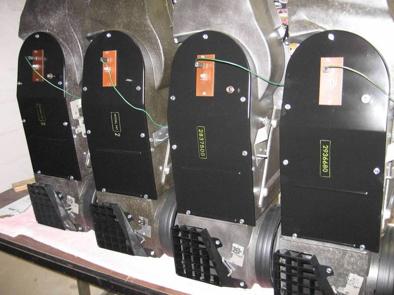

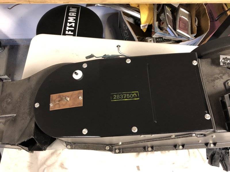

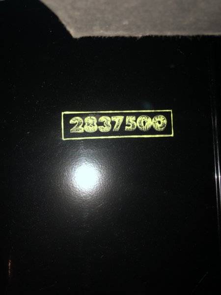

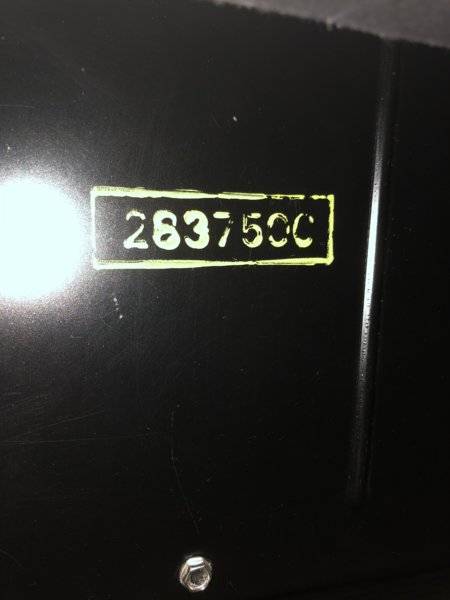

What did you use for color, ink pad,OK, my measurement of the rectangle is 2 3/4 by 13/16. This is also what is shown in the David Wise books. Here are two pics from my cars, note the different font on each, but both do match pictures in the Wise books.

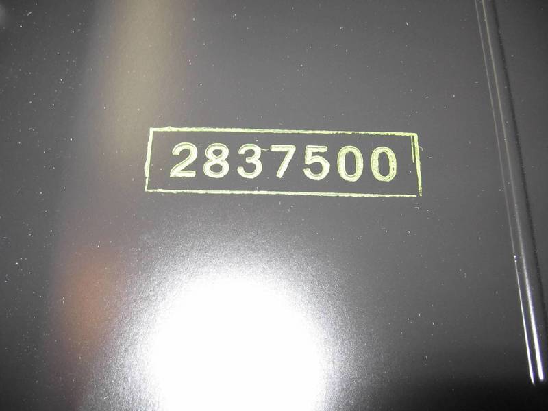

Thank youIll have to look at the color but I used ink in the bottle and squeezed it out on to a paper towel then placed the stamp into that as to not overload it with ink.

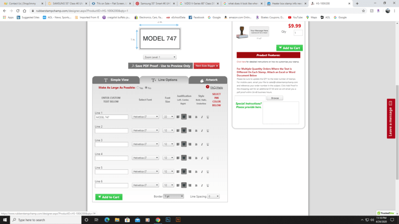

Was wondering if you had all the dimensions for the model 747 and the 2 stamps
