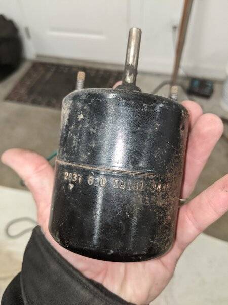

My blower motor - original from my car has 12V written in larger letters while the other one doesn't have that. Numbers between the units generally seem to match otherwise but also a couple of different markings on the top. They are "slightly different".
Has one been replaced?
Thoughts?
Why not do the motor yourself? Pull it apart and clean it up. clean the commutator in a drill press or even an electric drill. The bearings are likely still good and the brushes can still be had through an electric motor repair shop - if needed. Keep in mind that for the rest of its life it will see minimal use so pissing money away on something that you can't see is crazy.

I have 2 blower fans so maybe I'll tackle that. What is the commutator and how would you clean it with a drill?

The commutator is the copper part on the armature that the brushes contact. Its usually has some wear and signs of heat. You mount the armature in a drill and turn it. If the comm has heavy wear I hold a file to the comm as it turns to smooth it out (doesn't have to be perfect). Then polish with sandpaper - usually finish with emery cloth. Then with a fine knife or pick, clean the crud out of the grooves. Then one final turn with the emery in case there are any burrs from cleaning the grooves. A dab of oil on the bearings is about all they'll need.

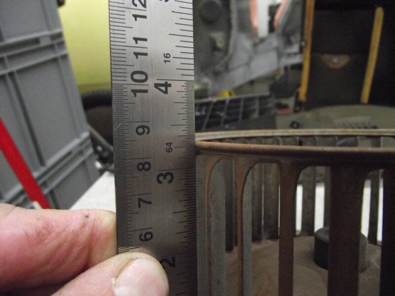

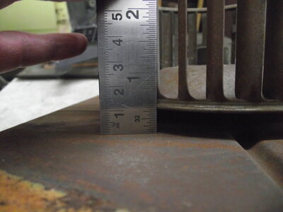

Did you measure the fan height before you took it all apart ?!?!?
Do both motor have the hole for the tube?
I did not measure it. As far as I could tell it just gets pushed tight to the backing plate no?

You could even the guts out of the new blower motor and put them in your motor housing - after you're stripped it and painted it.
