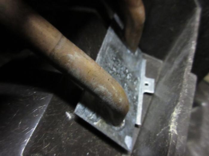

This little bracket is welded a bit too far down the pipes, and the pipes aren't angled quite right -

I remember having the same issue with the bracket, not correctly located at all. It wasn't too difficult to get it off and solder it back at the correct location and angle. I am not sure but I might also have heated the tubes and slightly bent them.
Works fine now.
If I were experienced with that kind of thing I might try fixing it too. I've never tried soldering metal parts together before, only wires.

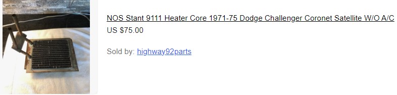

Just completed a rebuild on my 72 Charger. There was a guy who had a few NOS on ebay and they were reasonable. His ebay name is highway92parts

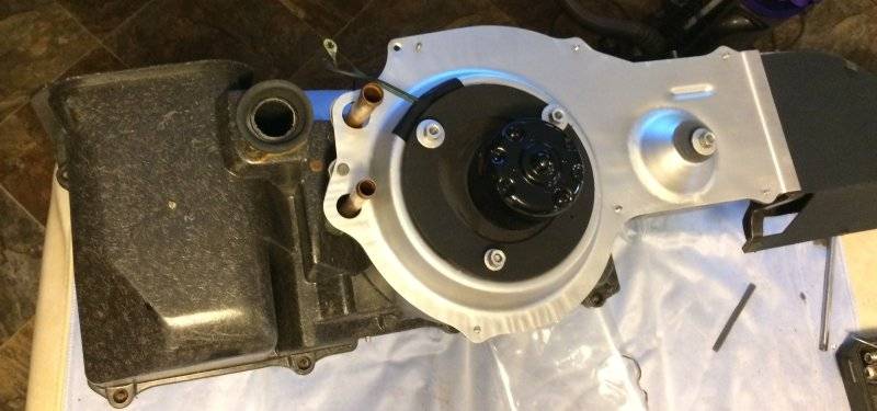

2nd Four Seasons 91523 -
The brace on the pipes is wonky again, but I think I can work with this one.
I think this bracket would be o.k. if I repositioned it on the top pipe. This is definitely solder, right? I guess the part is heated with a propane torch? I doubt any soldering iron I've ever owned would heat that much metal.

Gaps on the heater core end -
That is a very common problem with these as far as I have seen in the aftermarket world. I understand the expense part of redoing an original but how much is YOUR time worth. I would have sent it out and had a new core put in it. I know it's your time only but sometimes you need to put a value on time to see if it's worth it. Not to mention if you crack the core while moving pipes around and it leaks you have to this job all over again.
