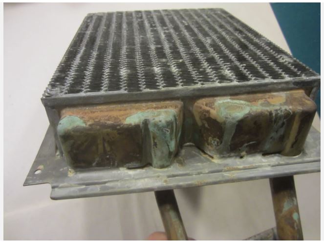

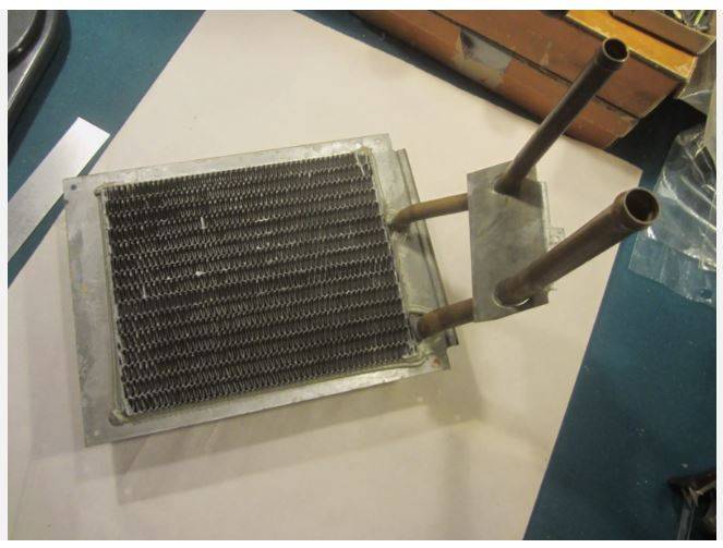

Just wanted to say Thank you. So, the core I bought does have a little corrosion on it and I believe that's due to the box getting wet at some point over the years. The relative I sent this too thinks it's bad but, I think it will be fine. The seller I bought it from has sold almost 14k items with a 100% Feedback so, I'm hoping I should be good. I'm thinking it can be cleaned up with either some "Never Dull" or "Brasso" and also hoping the relative won't throw it out. I'm doing this as a favor and since they are helping another relative with other things but, I guess we'll see.
Here's the description:
"Offered is an original Everco H2227 heater core listed for these models without A/C: '71-'76 Belvedere, Coronet, Satellite, '71-'78 Charger, '75-'78 Fury, Cordoba, Magnum, and '77-'78 Monaco. See catalog photos.. This is an early product made of copper and brass with a metal frame, not the aluminum type currently coming out of China. Item may have discolored over time and the box has light soiling, but this should do the job."

The applications that the seller has listed for Everco H2227 is correct. Although it may not be pretty it is likely better than most made nowadays.
The corrosion on the core is not an issue. Most of it has likely been there since shortly after it was manufactured. Getting wet might have added to it a little. The components are soldered together with acid core solder, and the acid residue from the process causes the surface corrosion. In general the green discoloring on the brass/copper parts and the white/grey on the other parts will not be any problem and the core can be used as is after blowing or rinsing any loose dust off.
To clean the outside, I would use white vinegar or diluted hydrochloric acid (muriatic) and a soft brass bristle brush to gently clean any loose material or powder, but not worry about any remaining color. Then wash/flush it with a mixture of water and sodium bicarbonate (baking soda) to neutralize any acid residue, then rinse with water. Air dry or lightly blow dry. The inside can be rinsed with low pressure water (less than 16psi).
