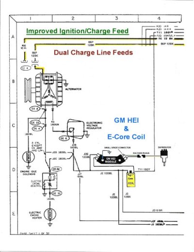

Here is how I have my GM HEI wired into my "74 SE. Never experienced the run on you speak of. Hope that helps

I agree with Bob and others, there is nothing wrong with simply wiring the start and run wires together, and connecting a single wire from there to the + side of the coil and then on to the module. The start lug inside the ignition switch will be energized while running, which is not a problem because it does not contact anything while key is in run position. I have mine wired this way. If you discover that you have a voltage drop, then the relay Geoff suggests is the fix. I also have an adjustable electronic voltage regulator on mine that maintains the system charge voltage at 14.2.
