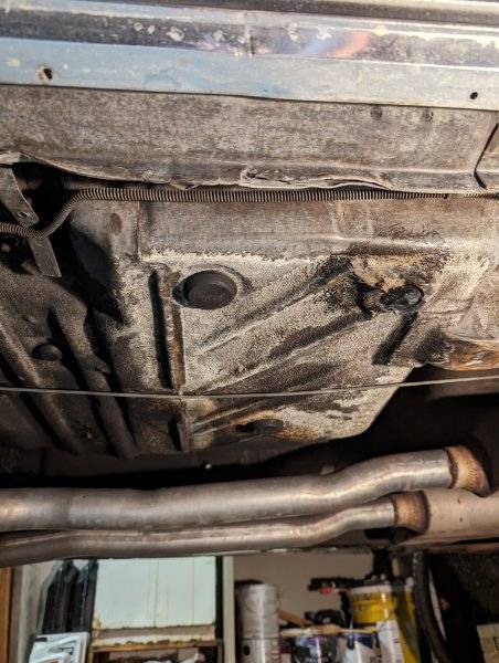

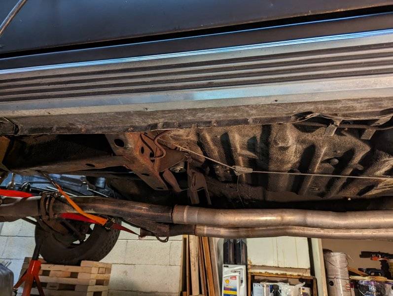

I recently pulled the engine, trans, and fuel tank. Now starting on some body, chassis, and fuel system items:
- Patch rear footwells (very bad rust through)
- Subframe connectors- I hear this will be "fun" due to the isolated torsion bar crossmember in the way :/
- Fuel system rehab & planning
-- tank cleaned and new 3/8" pickup installed
-- rebuild existing Holley Street Avenger
-- Aeromotive fuel log w/ double adjustable regulator
-- plumb in a return line
-- new mech fuel pump
