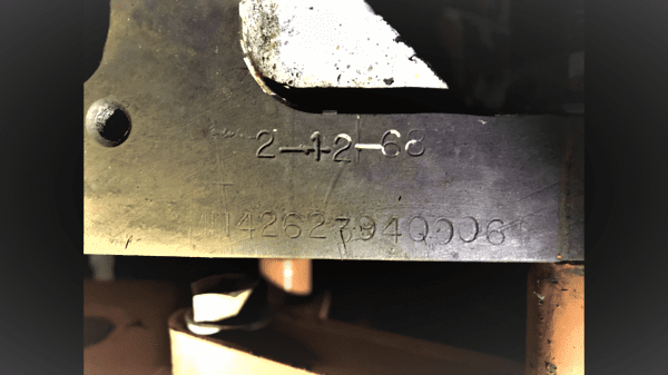

I flipped the photo and increased the size. This might help identify as the number is more legible.

Hello i’ve been a car guy my whole life. Last few years have been getting into Mopar‘s. I’ve acquired a 426 Hemi Marysville Engine plant Assembled February 16 1968.. 0006 Assembly sequence. Came out of a car from lynch. Taking a shot in the dark and wondering if the car is still around. The best that I can tell vin on the block A239015. Not easy to read at all. Any help would be greatly appreciate it. Sorry if this is the wrong spot for this post. I didn’t see anywhere else to put it.
take some 400 grit and polish up the stamp. Correct number will greatly enhance your chance of finding it
You can take some thinner and rob off all the old grime and paint out of the stamp…. Then get some white paint ….paint it….then sand off with 400…..should be way easier to read
I have reunited 2 Hemi’s with the cars they came from and it’s no easy task. You need to start with the person you bought it from and chase the ownership history
