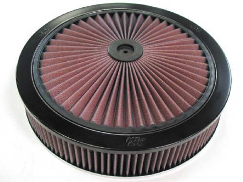

have you thought about one of these? it's what i run on my car. no restrictions whatsoever. F14603038.jpg
have you thought about one of these? it's what i run on my car. no restrictions whatsoever.View attachment 159085
69 that's what I was thinking about, but the lid is effectively rubbing on the hood insulation pad, so I'm not sure I'd get any air in the top anyway. Maybe I shiuld take the pad off the inside of the hood. Probably doesn't do anything anyway...

http://www.knfilters.com/mobile/default.aspx

I had the same problem It would fall on its face when I stomped the gas I went to a K&N and it solve the problem
I'll be following this thread for sure. Not sure if I'm going to have any clearance hood issues in my RR when I love the 383 for a 440 with an Edelbrock intake (RPM I believe) I was hoping to sue my oval cleaner on the car now but if it won't fit I like the look of the K&N X-Stream one pictured.

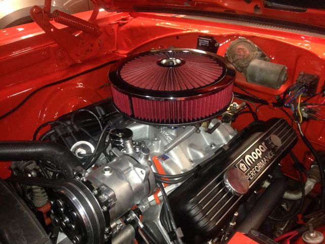

So here's my new setup (with thanks to 69roadr for the suggestion). It's a Spectre 14" by 3" filter with a dropped base. The base itself has indentations in it to get around (over) the fuel bowls on the carb, and I had to "relieve" these even more with a ball peen hammer to fit over the high screws on the top of my Quickfuel fuel bowls. Didn't take much though.
I checked the inside clearance based on 67Coronet's suggestions and there is still about 1.5" between the top of the carb and the inside of the filter lid. Good thought too. I can imagine guys restrict that space down to a half inch or so (with a 2" high filter) and would NEVER figure out the problem! We'll see if this one survives the Mighty Mopar Vaccuum...
Goon that's a Sanden air conditioning compressor with a Mopar-style dual-belt pulley. It's there to replace the factory compressor which is like having a Harley Davidson sitting on top of your engine. You can see that I don't have it plumbed into the A/C yet. On factory A/C cars there is no way to replace the compressor with an idler pulley (no one makes one) or to modify the pulley system to run without the compressor without changing out the crank pulley, the alternator pulley and the power steering pulley also. They are a set so you are either an A/C car or a non-A/C car.
The compressor is from Bouchillon Performance (great guys - Randy and his son Randy - on the internet) as is the mount setup to mate it to the existing factory brackets. The other pulleys are stock. That's a Bouchillon kickdown cable as well under the carb there, and their bracket. Replaces the factory monkey-motion linkage with all the joints and pivots.
And an A.R.E. throttle return spring bracket from Hughes Engines - which I painted Allis Chalmers orange. Don't tell anyone.
Oh, and because it took me FOREVER to figure out what to use and every engine seems to be different, here's a favor (I hope): Those are Billet Specialties spark plug wire holders (the metal ones on the valve cover http://www.jegs.com/i/Billet+Specialties/135/69782/10002/-1).
My poor wiper motor is starting to feel really neglected in there. I started to pull it out the other day, but it's really hard with the engine in there - go figure...
