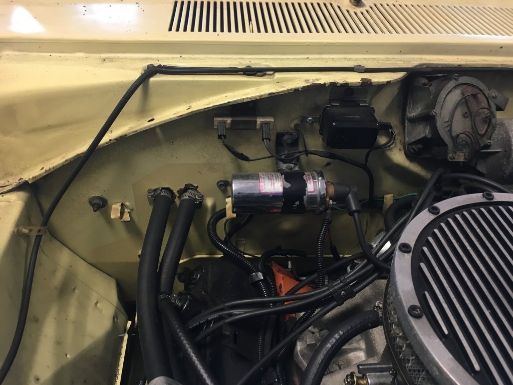

Let's start off with I suck at wiring! Lol, never had much experience with oe wiring since my other car has a painless kit. About 2 months ago I took my car in for paint. Drove it down, from now and then, picked it up the other day it won't run! Getting gas, cranks fine just seeming like no spark. I have replaced the battery, coil, cap, rotor, ballast resistor, still no fire. It is equipped with petronix igniter II too. Another question is what's this black box to right of the ballast resistor? Part of the ignition system as well? Thanks all.
A couple of thoughts. 1st, the black box looks like a voltage regulator. Since your problem started after a recent paint job, I would look at a bad ground. I am not sure of your exact set up, but I had a problem with spark due to the ignition box not having a good chassis ground.
Good luck.
The black box is the voltage regulator, have you checked for spark? If not pull a plug and wire and ground the plug while having somebody crank the engine (Be careful to keep your hand away from the plug).
A great percentage of electrical problems are due to a poor connection somewhere.

Voltage reg gotcha, I painted the engine bay before paint and it was running perfect before I took it down. I pulled a plug and didn't see any spark...

Intake is acting as ground. Speaking of grounds, think in the pic I see it, but if so, wire is too small. Talking about the engine to firewall ground. Make sure it's connected...should be 10-12 gauge wire, I believe.

Well all the culprit was...drum roll please.....the petronix ignitor! After changing out everything I did the trouble shoot on it and sure enough no juice. Picked up another and boom fire on the first turn. Thanks for all the help guys see you in the wind.
