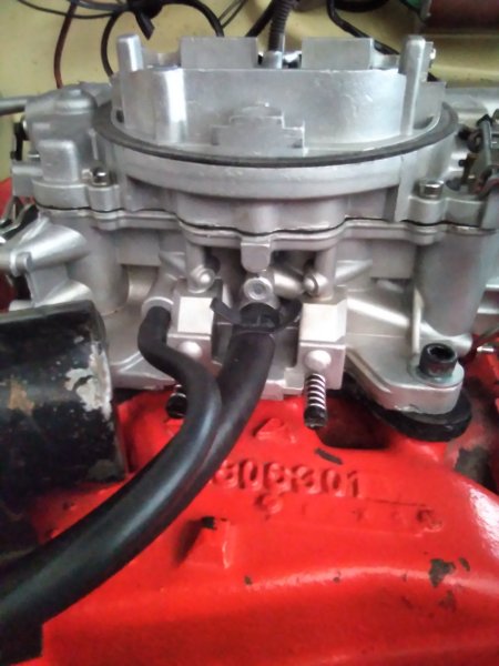

1. 1969 Super Bee with 383 Carter 4615S will not idle below 1500 RPMs engine dies because of lack of fuel if you pump throttle it will pick back up and run until RPMs drop back off or you squirt gas down carb to keep running.
If you open idle screws 7 to 8 turns open it barely tries to idle but still quits.
Engine runs fine above 1500 to full throttle position.
I have disassembled carb 2 times cleaned and blew out all passages and never found anything wrong. ( I am not a Carter expert by any means )
2. I installed a Street Demon 625 from another car to see if carb was the problem or some else was wrong.
Engine started right up and idled down to 700 to 800 smooth and steady no problem.
This proves to me the Carter has a problem with it not engine, ignition ect.
I do not know how to get the idle circuit to work ?
3. Any help or ideas ?
If you need more pictures or information let me know.
Thanks Gripper

you say "idle screws"? There is technically only one "idle speed" screw and it's facing forward on the pump side at the throttle lever. Funny thing, though, you said "screws" and you show an image of the idle MIXTURE screws.
Which ones are we talking about? The idle Mixture screws and the idle Speed screw behave differently.
To set the engine (curb) idle RPM speed, you use the single "idle speed" screw on the pump-side of the carburetor, pressing slightly on the primary throttle shaft lever.
When fiddling with the air/fuel idle mixture (in use during engine idle) there is a procedure for turning the mixture screws to achieve a peak in engine idle RPM. But the procedure includes correcting the idle RPM using the other single "idle speed" screw.
The carburetor in your image looks really clean. Maybe it works fine, and the idle mixture got out of whack attempting to change the idle speed? Or are you attempting to set the idle mixture? If so, 7-8 full turns from fully seated starting point seems much greater than the last few I have counted on a rebuild.

It could help to have more pictures of both sides, the rear and the top of the carburetor.
