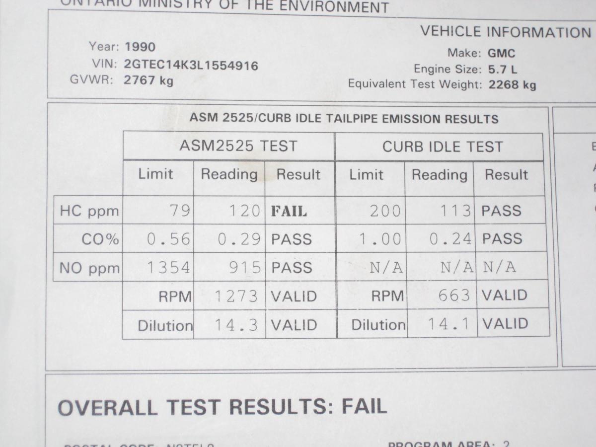

Hey all my 1990 GMC 1500 pickup just failed it's E-test.
It wasn't all that bad only high on the Hydro carbons.I knew the distributor was on it's way out so I swapped it out for a known good one.
When I started the truck after the swap it ran like crap the exhaust stunk like the cat had gone bad and it kept stalling.I figured the distributor must have been the problem so I swapped the original back in.
Now the truck starts rite up but runs sluggish at first then revs up and then runs perfectly smooth has lot's of power and sounds fine but the check engine light keeps coming on and I don't have a scanner.
I set the timing by unhooking the brown and black wire and set it at o deg BTDC and then cleared the computer.I've checked and rechecked the timing and the wires there perfect.I haven't had time yet to look it over so any one that's got a good of where to start let me know.I'm thinking the distributor has nothing to do with the new problems my guess is I set some thing else off when I was in there mucking around lol....Here are my E-test results:

Hey Ron thank's for the reply,I should have added the Cat is good I just welded the exhaust on a few weeks ago and checked it out then.
I didn't have time to look the truck over until after work today but I had it in my head that the Map sensor was the cause.
I was getting ready to unhook it and install the new one I pulled off of a parts motor I have when I found that the vac line into the back of the throttle body was worn out at the elbow and leaking causing the Map sensor not to work properly. ...........New vac line equals a happy day in Sundance land :icon_colors:
