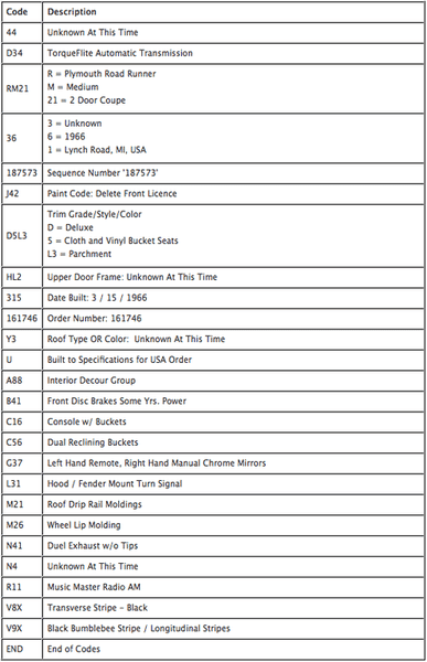

here you go:
Save the Image, I'll delete it soon from my photobucket account
Greets Miel
E44 (not "44") is 318 "36" is probably "G3G" which is 1973, 318, St Louis.
I think Y3 is JY3 Honey Gold, which is actually yellow, a bit more pale than Lemon Twist, but not a pale as Sunfire.
I think it's safe to assume the car is JY3.
Since there is no vinyl top code, we see the *Y3 above the J42 code. let's assume he got the Y3 part correct on the top and the J correct on the bottom (as we know *42 is not a valid paint code) giving us JY3; a vaild code for that year and appropriate with that interior.
How's this?
R11 V8X V9X END
G37 L31 M21 M26 N41 N42
JY3 U A88 B41 C16 C56
JY3 D6L3 HL2 315 161746
E44 D34 RM21 G3G 187573
For the record, I see LOTS of VIN "G" characters listed as "6", even on titles.
YIKES!
I love the ebay listings for "original engine" cars with 6 as the fifth digit.
YIKES!
You see a lot of them listed with a "C" plant code also. Sometimes the tail of tail of the "G" doesn't show up very well.
