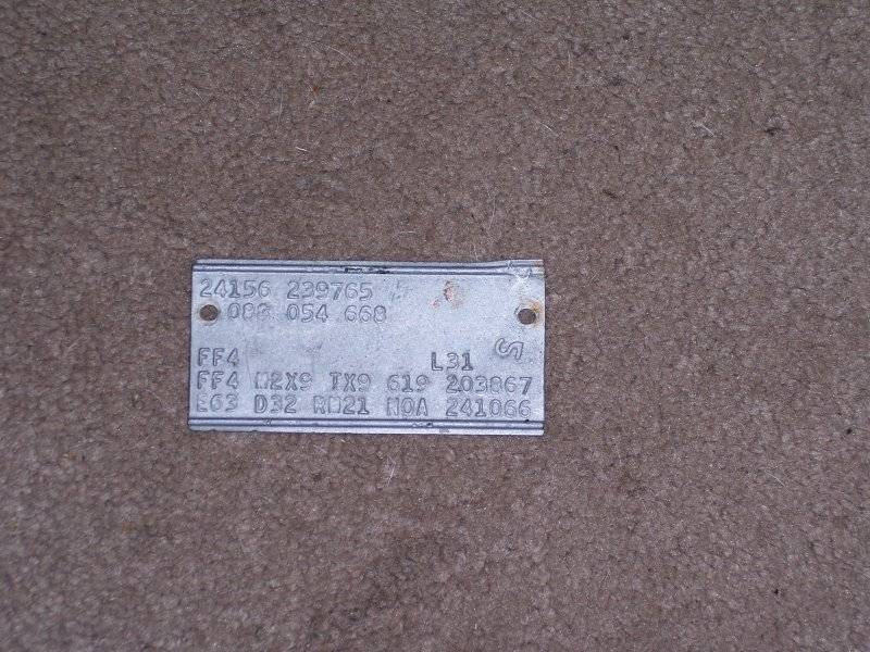

HELP decoding data plate 1970 Roadrunner
Elvira1963
New Member
6:22 PM
Oct 12, 2024
2
1
Iowa
Can you folks Please help me decode the data plate on my 1970 Roadrunner? I tried looking at multiple sites with little luck. apparently these Lynch road cars are hard to decode?
thanks
088: orange engine assembly for B/E-body - 383HP 4bbl (335hp) w/Holley carb. for automatic transmission
054 is a 3.23 open differential, 11" brakes
668 is a HD 727 3 speed
E63 = 383, D32 = 727 Automatic
RM21 = RR Coupe, flip out rear windows
TX9 = Black interior
FF4 = Light Green Metallic exterior
SPD = June 19th.
L31 = Hood mounted turn signals
H2X9 = Black split front bench seat
E63 = 383, D32 = 747 Automatic
SPD = June 19th.
thanks that is a big help
