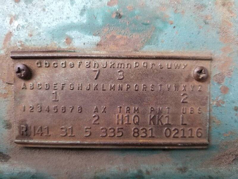

I've looked all over and I can't seem to find reliable decoding info for my fender tag. Does anyone know what this one says? Particularly interested in paint color. Any help would be appreciated.

1968 Plymouth Belvedere 4 door sedan
273 cid 2-bbl V8
3 speed automatic
Build date August 31 1968
Axle is 2.94 rear axle ratio
Interior - high trim grade Turquoise interior
Paint - monotone medium Turquoise metallic paint
Dark turquoise metallic upper door frame color
E1 cleaner air package
X2 tinted windshield only
h7 fender or hood mounted turn signal indicators
M3 ?
Hope this helps

Did you mean August 31, 1967 build date for the 68 model year?
