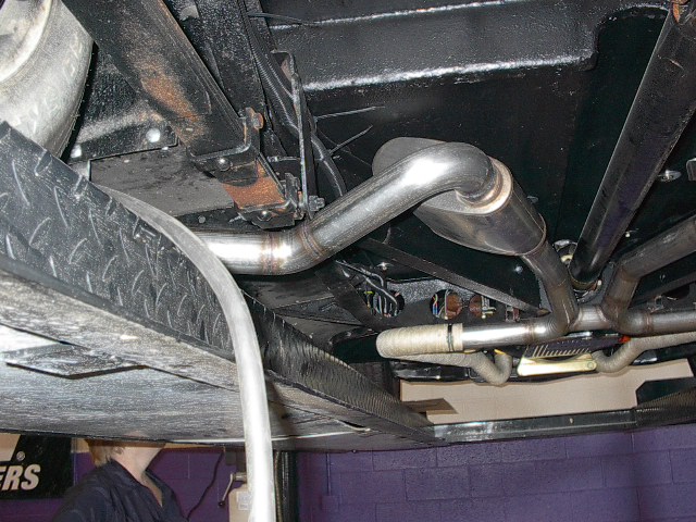

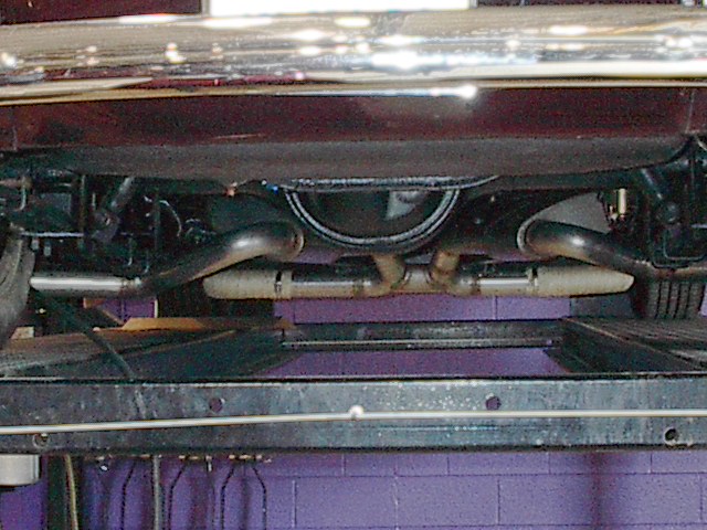

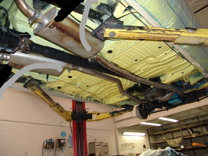

Here is what I did on my 40ford not a mopar but it does have a hemi and the exhaust exits in front of the rear tire. you get the ideal on the routing.
