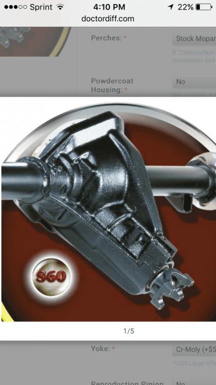

This is the only pic for now lol, I'll send you a picture of the invoice if you donate money to it :thankyou:
