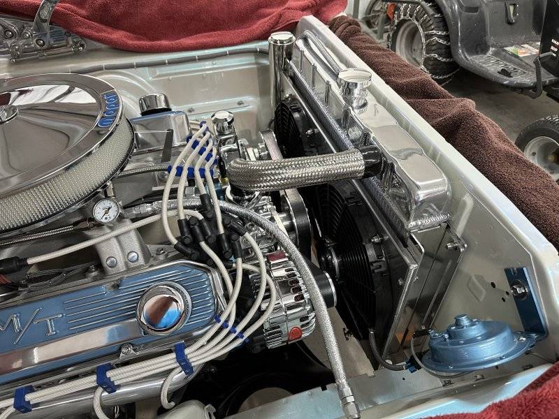

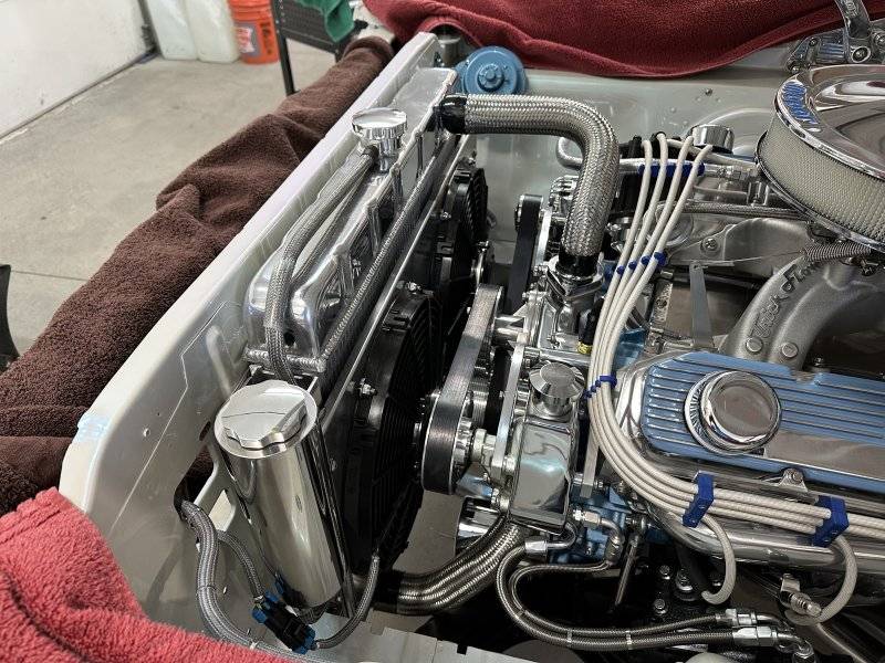

Cold Case with dual fans here and a custom serpentine belt drive.
Very nice! That's what I wanted the CVF to do. :*(
Did you fab it yourself up yourself?

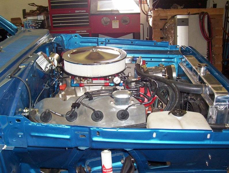

I used all of my stock 440 with A/C pulleys when I swapped over to the Hemi.
Low deck stroker here, not a Hemi but I still had clearance issues. The good folks at CVF helped me sort things out as best they could.
At the end of the day I had to play with fan width. It's still tight but works well.
The ATI balancer is too thick to use the stock 440 crank pulley. If I can get a custom crank pulley made, then I could use 440 pulleys for the rest.
What fan setup is that? It looks shorter than my cold case 12 in fans. The motors stick out too far on mine.
Got it from Entropy ECP but it's not one of their stock packages. 13 inch SPAL fans. The one on the power steering side was too tall and I returned it. Went out and found a low profile version on my own so it would fit.
I think I'm only getting around 2,600 cfm of pull but no problems so far. I have them set up on a Dakota Digital dual speed controller.
