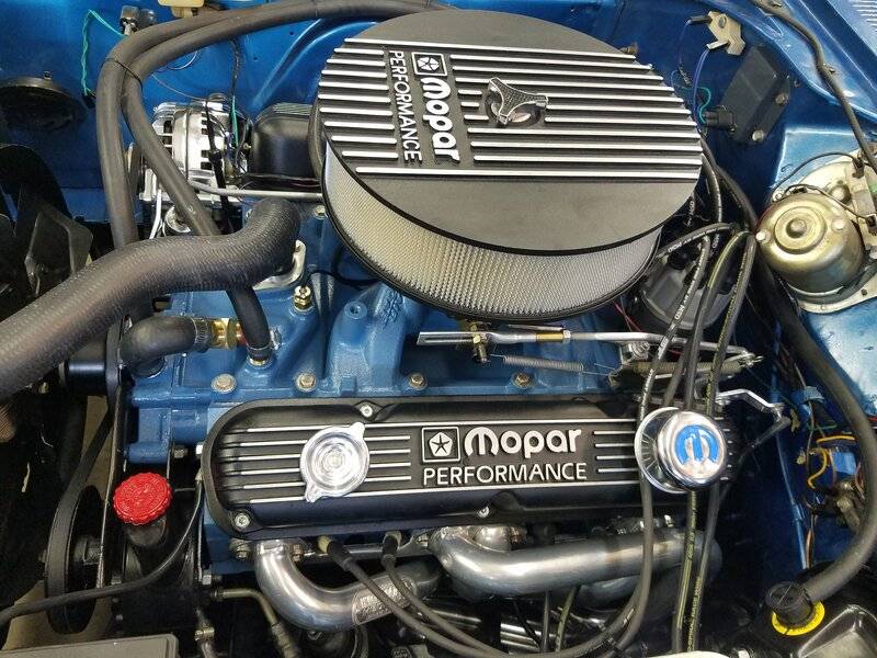

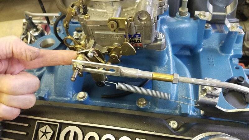

You can lengthen the throttle pressure adjusting rod pretty easily. Use apiece of 1/4" pipe threaded internally connected with a short piece of threaded rod. Making and extension piece for the cable is also easy. its just apiece of .060" material with a hole in each end. The biggest thing you need is the pivot on the Holley to be the same distance from the throttle shaft as the original carb. Otherwise you will never achieve full throttle travel. This is a Magnum with an Eddy RPM intake. But the idea is the same

View attachment 1271574 View attachment 1271575
Just what I was looking for, that helps a lot, thanks!

The threads on the rods on early set ups is 1/4-28. Not easy to find pipe or coupling nuts in fine thread - but you can cut your own .

What did you do to correct the pivot point of the cable to match the original?
Either drill a hole in the carb. Or look at the kickdown arm on the trans. There are a few different lengths. If you can't get the right length, cut the trans lever and weld it to the correct length.
