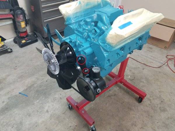

Help, I don't see a way to adjust the belt tension on the water pump/power steering belt? I just changed the water pump on the 318 and there is no way to take the slack off or adjust tension like there is on the alternator. Am I to just take the pulley off the water pump and fight the belt and bolts and get what I get for tension?
On my 340, you very slightly loosen the 2 bolts on the power steering bracket and there should be a square hole in the bracket itself where you can insert a half inch socket wrench into the bracket and pull tension on the power steering pump. I would think it's the same for a 318 but I could be wrong. Here is what mine looks like.
If there’s no hole you loosen mounting nuts/bolts a little and pry on bracket- but DONT pry on pump body/reservoir.
Loosen the mounting brackets for the PS Pump. You'll see it drop, there is a square drive for adjustments, or a BFB (big fu#*$n bar). It will be self explanatory when you loosen it.
Good luck
Awesome thanks so much guys!!!!!!!!!!!!!!!!! I see the square hold for the socket. Not a lot of adjustment range but enough I think....
You put the square drive of your breaker bar in the square hole. Adjust and tighten to specs. I always used the diameter of the socket I used to tighten the bolts as the "rough" way to judge belt tension.
