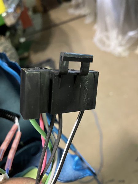

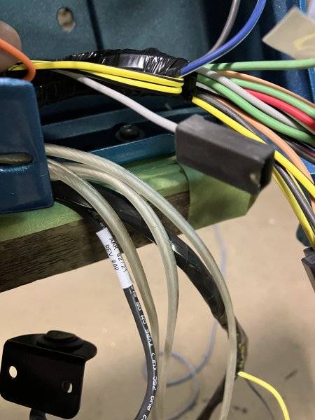

Hey Guys Got 2 Wires Im Unsure Of on My 69 Superbee Rallye Dash.
One Is a Grey Single Wire On The Drivers Side. Didn’t See It In The Wiring Diagrams.
And The Other Is For My Dakota Digital Headlights
It Says To Tap Into The Rear Tail Lights To Dim The Cluster When The Lights Are On. Im Sure Any ‘Lights On’ Wire Would Work.
Pic of Grey Wire And Headlight Switch
Any Suggestions?
As far as taillight circuit you can tap on to one of the two blacks that are doubled up in one cavity on that plug.
Is The Clock Constant 12 volt?
My Led Tail Lights Need a Contstant 12v Source
Thanks

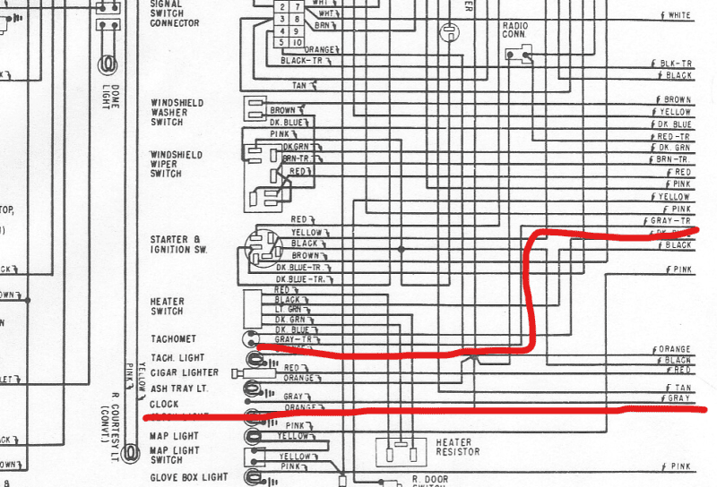

Clock is constant 12 V. Usually taps into hot side of ammeter.

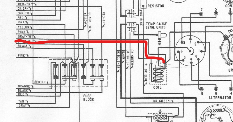

****Get an ohm meter out and check the negative side of the coil to the end of the grey wire under the dash.
I think it might be the tachometer output from the coil.
It pays to check before plugging - there is always a chance the wrong wire was used during manufacture....but @pnora is probably correct with it being the clock.
