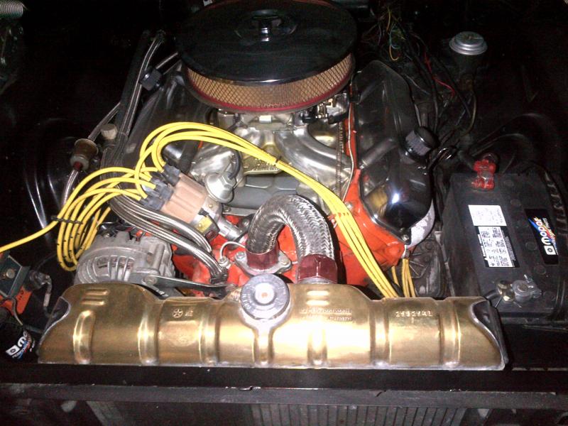

IMG-20120208-00150.jpg Put a 440 in it, it's a no brainer. Simple drop-in with the correct motor mounts. I converted mine from a 318 LA. I am still using the original radiator with no problems. If your tight on money find a good running stock 440, add an intake, headers and carb. The torque gain alone is worth the conversion any day, especially in B bodies. Then when you have the funds you can build a nasy 440 or stroker big block if you like.
