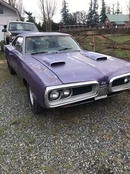

Hey everyone, I just got a 70 super bee with a 440 and a 4 speed. The engine has cleaned up 906 heads, fairly large headers, stock 4 barrel intake manifold, it is a 6 pack motor and has all been rebuilt with about 800 miles on it. It also has a fairly large cam with about 600 lift. It is only running a 750cfm carb and I think I am going to put an 850 on it that I have and I am wondering what would you guys choose for an intake manifold? I will be driving it on the street as well as going to the track. It has a 8 3/4 with 4.10 gears and a spool. I read in hot rod magazine that The Mopar performance m1 intake is the best one they tested, has anyone used one? Is it worth it to port the cylinder heads and Intake manifold? I’m 16 and looking to hop up my car a little bit. Are there any other good modifications I could do to the engine to get a little more juice out of it? Thanks in advance

It has the ram air big orange piece under the hood but no stock air cleaner, I would love to be able to use the ram air with an aftermarket aluminium manifold.
The options on intakes get really really slim when using the oval air cleaner base and air box aftermarket performance intakes are higher than stock. I’m sure someone has done it but it does limit you on intakes to choose from and if you haven’t priced them yet the 440 ram charger air cleaners are $$$.
