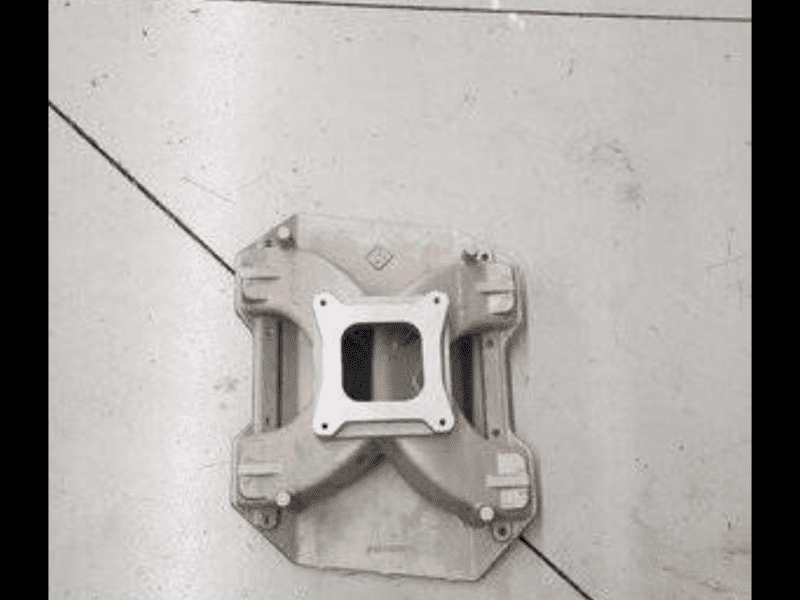

The 337 is intended for std height MW port heads(like stock MW heads) on an RB block.
If run on raised port heads, or something like stage 6’s with adapters, the valley plate will not seal the end rails.
There are 4 dedicated stage 6 manifolds.
All are for RB blocks, to be used without spacers.
There are std port and MW versions for both 4150 and 4500 applications.
These manifolds don’t fit any other combination of
heads/blocks.
One version is what came on the stage 6 headed MP 500” crate engines.
They’re not super tall, as seen in post #7.
About the lowest semi-suitable intake you’re going to find for use on an RB with stage 6’s while using the adapter plates is the Holley SD.

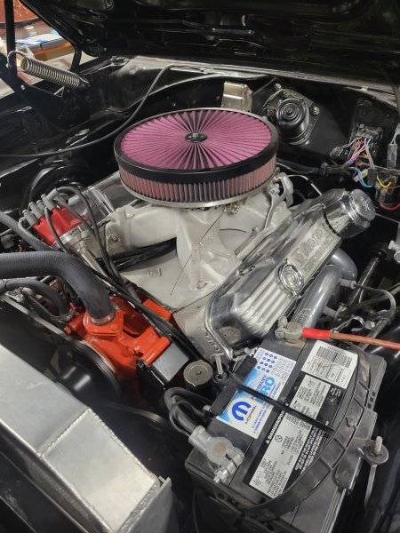

I have a 440 Holley SD intake manifold also but i thought this intake was too small for a 543 build.
The SD will go under the hood and has proven itself on the dyno many times.

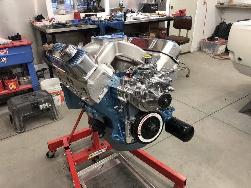

I see you have M/T valve covers.. did you personally install them? Any grief ?
Good eye Rem. No grief really. Those valve covers are circa 1975. The ones I ran back in the day. Had Cuda Chick polish and powder coat them. She did an awesome job.
I had to do a little clearancing on them to get them to fit the big rocker arm shaft mounts on the Trick Flows. Had to make custom baffles to clear the Isky rocker arms but other than that they fit like a glove. :lol:
Just to reiterate, and hopefully not confuse the issue any……
Using raised port stage 6 heads on an RB block with the adapter plates allows the fitment of any normal RB width manifold to be bolted on.
So, the 337 would physically fit, but unless the heads/adapters are MW size, there will be a port mismatch.
And, it’s likely that combo won’t fit under the flat hood and still provide adequate clearance for a decent air filter.
Additionally, the built in valley plate won’t seal to the block without spacers fabricated to fill in the gap.
There is really no upside to running that combination of parts.
If you felt like you needed that style of manifold to run with stage 6 heads on an RB block, you would just run the particular stage 6 manifold that fits the desired port size/carb configuration, which allows you to nix the adapters.
The std port/4150 carb version is P5249358.
GTXJohn had one of those for sale a while back.
Also, the numbers cast onto the manifold are “casting” numbers, which are different than the part number.
