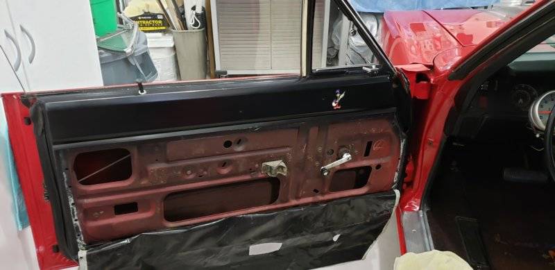

Replacing a vent window on my '70 RR.
From pics, here's where I'm at... the bolts are out on the window supports, but is there one more thru the small hole? Seems like it might be an Allen head screw.
Also, do I have to remove the regular window to pull out this vent window... looks like a pain!
Any help appreciated.
should be an allen screw in there if I remember correctly - took my 68 Charger doors out YEARS ago
I also took the glass out at the same time - the vent window frame comes back ad it comes up and out so I think at minimum you need to remove the rear window track bolts so allow the window glass to slide back - in reality it is safer to remove it completely - prevent possible breaking it
BTW.. that's a 3/16" allen key ! Unbolt the regulator and slide it back off the window lift channel to make life easier.
