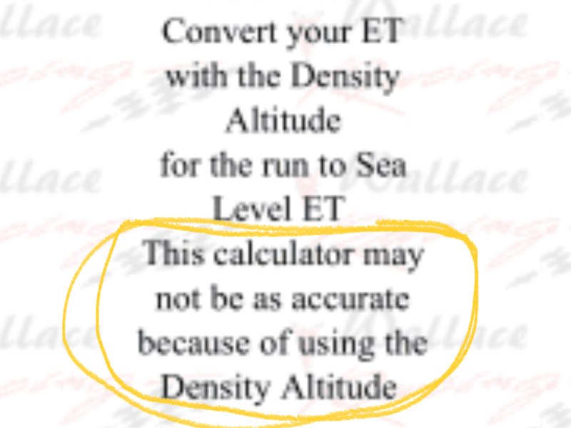

There should be an altitude factor for pomona..... but it's downhill so they figure it cancels the altitude out, lol.
I put a lol, but I believe that statement is true.

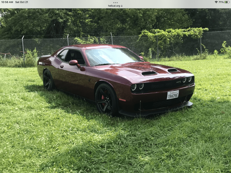

How about high 10’s? 10.8 @ 131. Get your checkbook.
