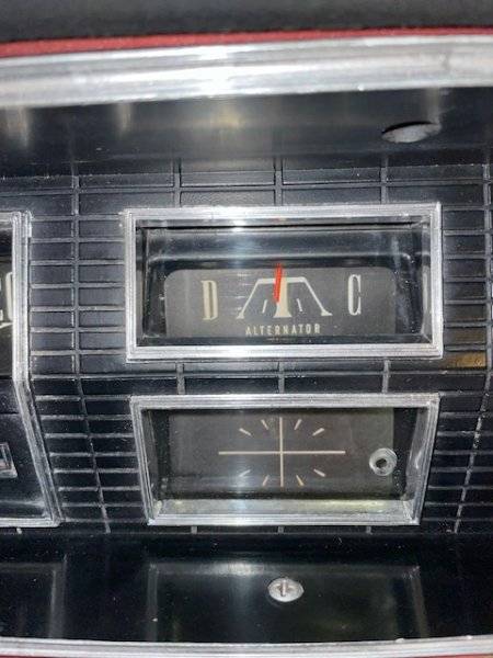

the below shows where the gauge sat
car on and in idle

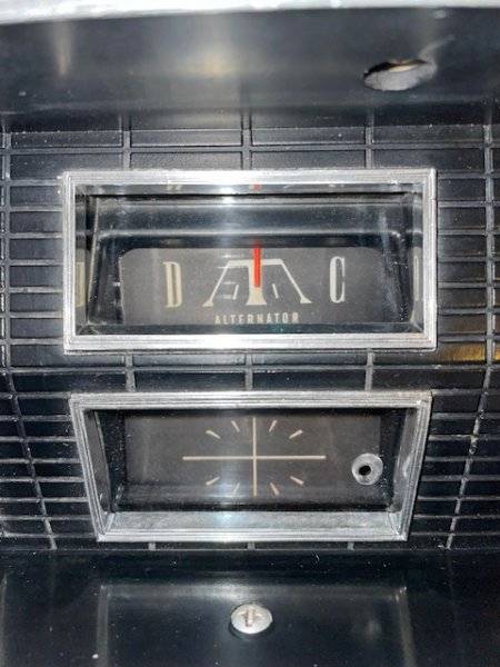

car off headlights lights on

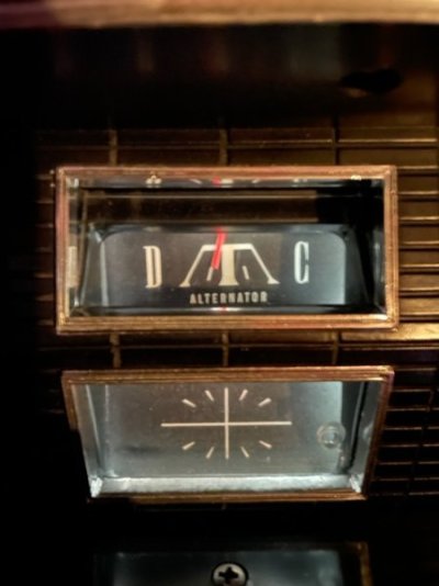

car off
Looks to me like your alternator is not doing anything. All your power is coming from the battery.
Agree with previous post. If your battery is not fully charged (like immediately after you use it to start the car) and your alternator is working properly, the gauge should react immediately when you increase RPM’s and the needle should move to the charge side until the battery is fully charged and then needle should stay in the center (assuming RPM’s remain high enough - slightly above idle is usually enough). Looks like your alternator is not working correctly.

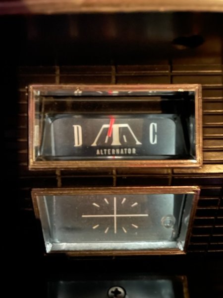

But then I took it around the block again today after letting it warm up and the gauge stayed in the middle the whole time
Thoroughly check all your wire connections including the crimps. Also all the ground wires, they are just as important as the ones carrying power.
