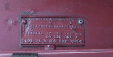

I have a question for all the numbers people out there. 67 and 68 fender tags were very similar, and I have a bunch of 67 stuff. Where on this tag does it indicate a 68 car and not a 67?
Hmmmmmm good question. Only thing I see on this 67 tag in the pic is the SO number is only 5 digits. 68 started with 100001, but this car was an early build. Once they hit the 100000th car, I'd think they were the same. Tire code also looks like 3 numbers in the 67 tags vs 2 numbers on a 68 tag. I am reading that the third tire numeral 5 means there are 5 tires the same meaning it got a spare. Others can comment on this if its wrong/off. Seems the 66-68 stuff is more mystery than the 69 and up stuff.
