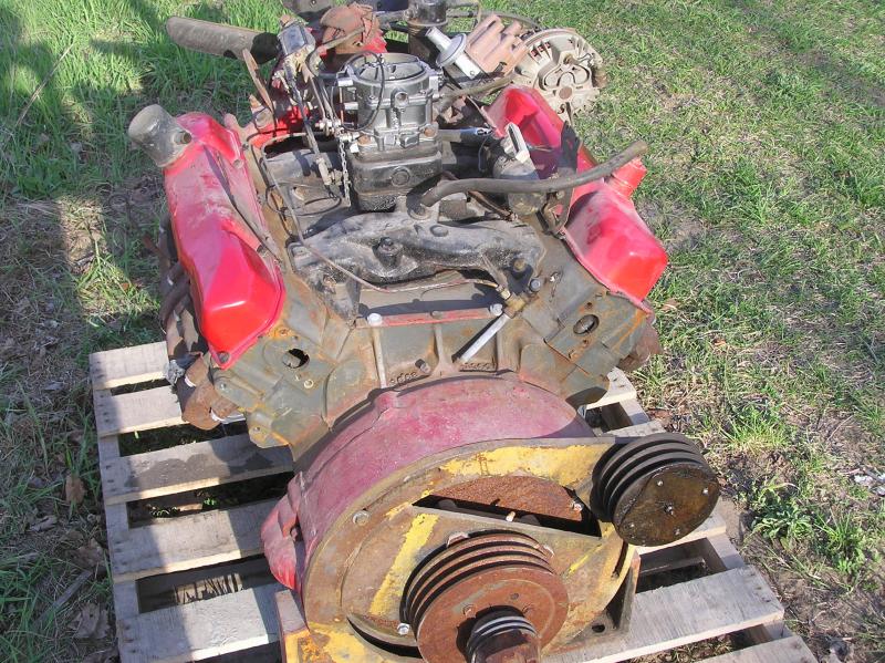

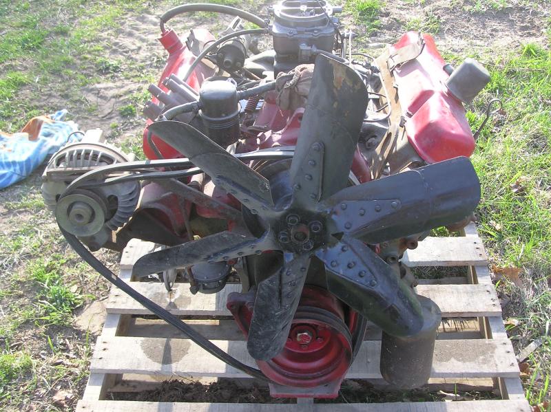

Ok guys, I need a little help Identifying an engine.
It must be an industrial motor, but would like to know exactly what it is.
And would it be good to use in a Charger?

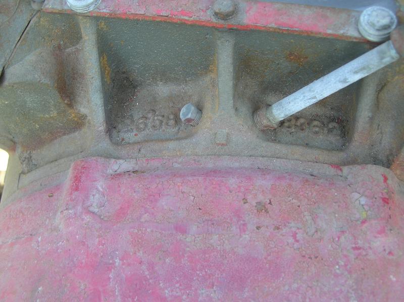

The only numbers I can find on the block are at the rear above the pulleys in picture #5

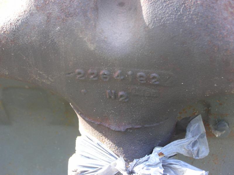

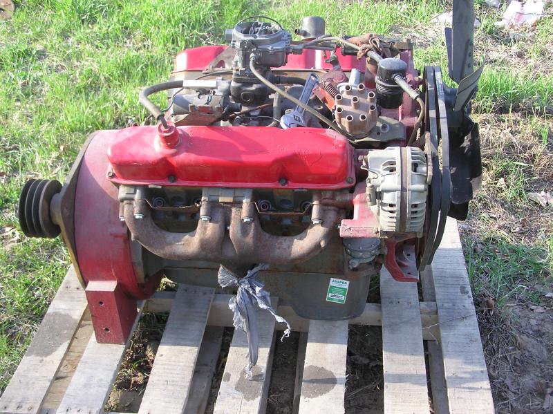

Picture #8 shows the casting numbers on the exhaust manifold

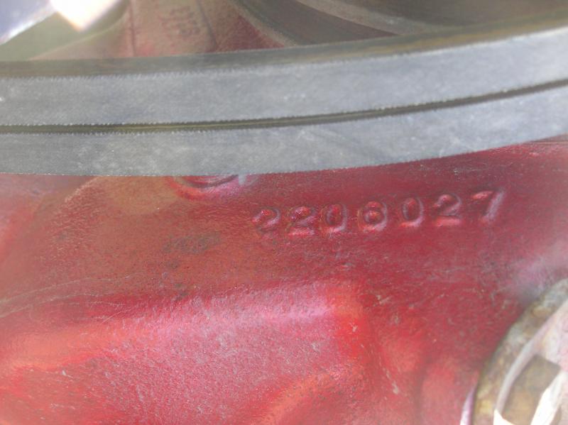

Picture #9 shows casting numbers on the water pump

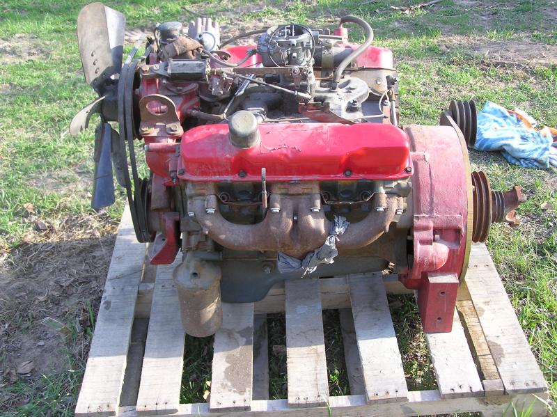

Here are some pics.
The high mount fan/water pump tells me it's a motor home/industrial engine.....
The block number 2658836 dopes out to both a 413 and 426 Truck/ Industrial engine, though it's most likely a 413. The same casting number applies from '66 to '77
I think you could find a much better engine to put in your charger. The exhaust ports on those are completely different than normal heads, as I recall, as well as aftermarket pistons are difficult to say the least... Top that off with some were reverse rotation (again, its been awhile and the numbers guys would know better)

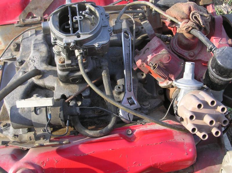

I have the same casting 413 in my Satellite, but I only used the bare block. These blocks are reverse rotation and chances are that it has the 8-bolt extended flange forged crankshaft. Mine did, anyway. The block and the rods are probably the only items on this type of engine interchangeable with regular RBs. And yes, that is an RB 2-bbl intake. Perhaps something for a 440+6 as an 'economy' option...:evil1:

it's a stationary drive motor for sure. you can tell by the mounts on the "bell housing" and the lower front. Usually there was a hand clutch that you could engage after starting the engine. who knows, maybe they used an idler on that belt set-up. would be curious if within that bell housing the output is solidly linked to the crank/flywheel or it's a centrifugal clutch of some sort.
Could have been used as an irrigation pump motor, generator drive motor or even a tornado siren. My guess is that it's a 413. The airport in Bakersfield had a 354 stationary Hemi (might have been a 392) that it used to run a generator for various uses. Either way, as BB said, the are very different and you'd be better off to go another route. I would be curious to know the history of this workhorse. kinda cool...

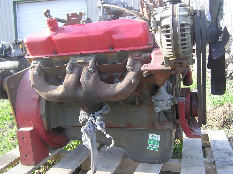

He bought it from an airport that had it rebuilt 20 years ago by Jasper. It's been in storage ever since and was never used.

That distributor doesn't imply it's counter rotating.

As I noted previously; I have the same casting 413 running in my Satellite. I will elaborate a bit more on this. The block is 2658836, but the rotating assembly I put in it is from a 'regular' 413 with the 6-bolt crankshaft flange. Yes, the measurement from the rear main seal register to the crank flange is different, but that is because the flange is extended more outward from the block. This will be a problem if you are looking for a transmission to fit to the back of this crank. I did a search on the internet once for the application of these cranks and somewhere it was mentioned that these cranks were also found in early Max Wedge engines, but I cannot verify this and I still think that the problem would arise of getting a transmission to properly attach to the block and crank. The flange on the crank in the Industrial 413s I had was flush on the transmission side.
The block is essentially the same as any other RB, with the difference in the additional strengthening ribs on the sides of the block for the 2658836. That is why the casting number is on the top rear at the bellhousing flange. The ID pad on the front if the engine will be stamped similar to regular passenger car engines. The 413 in my Satellite is stamped G413, which makes it a '71. The other Industrial 413 I had a few years back was casting 1852029 and was stamped V41, which would have made it a '64 model year engine. The number was cast on the side of the block, as on regular RBs. The rotating assembly, however, was exactly the same as on my '71 413. This engine would make a nice MW tribute engine with almost all the markings for a 62 MW engine (AAQA on the front, 1852029 casting number), but the V41 would and single R cast on the front (not R2 or R3) would definitely rule it out as a correct engine.
The engine is most likely reverse rotation, with the rotation being different on the camshaft (not the crankshaft). Both the Industrial 413s I had, had the direct drive camshaft sprocket. I don't think that the timing chain was used on the Industrial engines until the 413 was replaced by the 440. The crankshaft is normal rotation, just the camshaft is driven directly by the crankshaft. There is no layout change between Industrial engines and regular engines to accommodate this sprocket and I can confirm that you can use a regular camshaft with timing chain etc. on this Industrial engine, too. Just strip the engine to the bare block and treat it as a regular engine during a build.

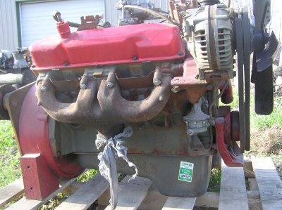

Based on the fan that's on it, it spins in a normal rotation but that won't matter if all you are using is the short block....

hey the distribtor looks to have a govenor attached to it , that would make one hell of a power plant for a BRUSH CHIPPER, wood chipper, that would B SIR C-H-O-M-P-S A LOT ! ! ! and then some
