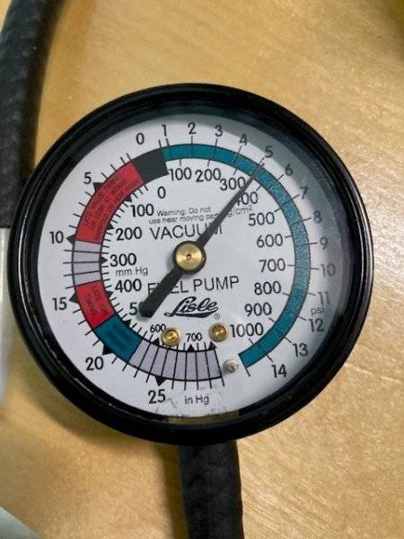

Yeah, that seems really low. Since it's all of your cylinders, not just one or 2, I suggest that you check your test equipment (gauge, hose, etc.) and your process just to make sure that is an accurate reading. A couple of years ago, I was chasing my tail, wondering why my vacuum was so low. One day, after yet another fruitless search for a vacuum leak, I realized that my gauge was, well like the picture below. Don't be like me...
