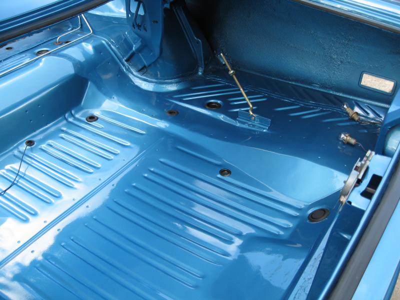

I don't have dimensions but you may be able to reference it from grooves or plugs in floor. This was my 69 Coronet R/T
Ron

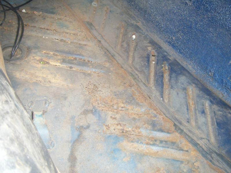

Hey Rhelwood, I went through this exact situation with my 70 Roadrunner convt. I took a bunch of pictures at the 2011 Monster Mopar in Indianapolis. I made sure I only took pictures of original Roadrunner convt.'s when the owner of the car was there and could confirm it's originality.
The '69 Roadrunner convt's use the "loop and hook" like 5-windows links (see my pics attached) and it was the '70 Roadrunner convt's that used the '71-'72 hardtop brackets. That's not to say there couldn't have been some kind of mid-year change, but this is what I found on original cars.
Hope This Helps
