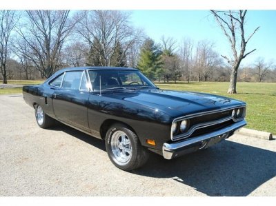

Your info is really helpful., I do have the reciept and worksheet in case you have any comment. Also pic of the beast. :icon_thumleft:
