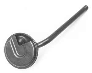

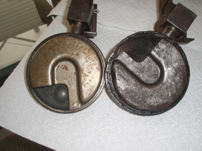

Hi can someone give me some advise here...I'm trying to repair the "head" of my Max Wedge swinging pickup.
I need to make it the same as the one on the left.
Is it possible to get an un-assembled unit from Chrysler?part #5249817
I'm thinking i can replace the whole head and put the screen opening in the correct position .
Any ideas?
I don't think it matters where the opening in the screen is. It's pretty well submerged in oil, or should be.
x2. I would just repair the crimp as best I could and run that joker. It looks good and clean to me and that's really the most important thing.
