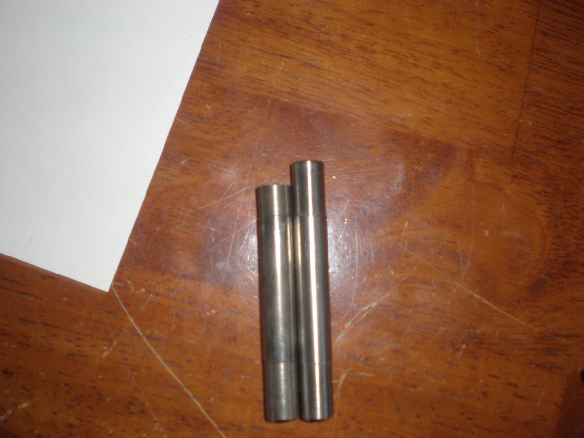

worn pump rod can still pump but it pumps weaker, think of a hand pumped water well if you were doing slow short pumps it wouldnt work, fast short pumps it will work just not as well as fast full pumps, if you can picture what im saying. hence turning over slow short pumps no pressure, engine running fast short pumps fuel flowing just not at full pressure.
mopar fuel pump rods are junk , get a hardened one from hughes http://www.hughesengines.com/Index/index.php
ask me how i know :grin::grin::grin:
