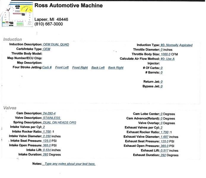

Sorry .......A miscalculation on my part the compression is 10.25 @175 PSI and not 9.5
if this helps... my paper work is not in my file
