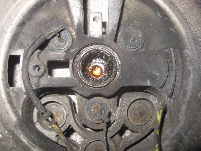

Even the alternator is not cooperating. I removed the single groove pulley, disassembled, and got a surprise. See the rectifiers missing the leads on the right. That is why my lights are so dim. I got a new one from Car Quest using the 25% discount code online pick-up in store method. It is great to have a 1970 part in stock at a local store. I also bought some pos and neg rectifiers on the bay for cheap. They just press in and solder. So I can repair and keep the original. The one I got today is a 60 Amp squareback 2 groove type.
