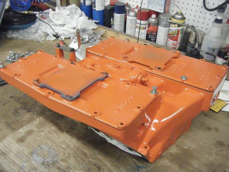

hello all
are there any lock washers or washers under allen bolt fasteners for cross ram intake
thanks'
sjm
No lock washers. A&A trans sells bolts with captive washers, ask if bolts are he same length as earlier Xcrosrams. I retorque bolts until they compress intake gaskets.
