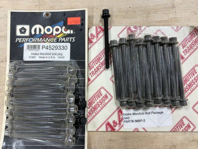

Is there a set of hexhead bolts or do I get bolts and cut to proper lenght?
Thanks.

Yes, I understand this is important. Did you make your own set of bolts or is there a set to found with proper lenght?
I have no problem getting good quality hex head bolts and fixing it myself, just asking...
You can't make your own because they have captured flat washers. Just buy from A&A or someone else and cut 12 down to proper size.
4 3” bolts go under the plugs in the rear four holes (all the bolts in the kit will be 3") 6 2-3/4” bolts go in the carb openings, 4 2-1/2” bolts go under the four plugs in the front and and 2 2-1/4” bolts go in the exposed holes.

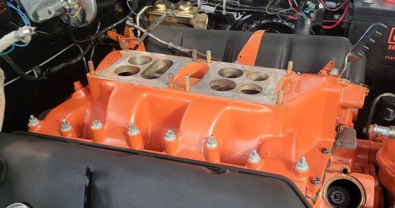

Mines not a crossram, But I made my own. All studs with captive washer nuts
I prefer studs like that on the intake. The reason it won't work on a crossram is if a nut comes loose it goes into the cylinder. And then it's a very bad day.

I know it's expensive and a hassle but there's just not a better way. I took 1 bolt out of the package to show the attached SEMS washer. The old Mopar part number is on there if it helps you.
