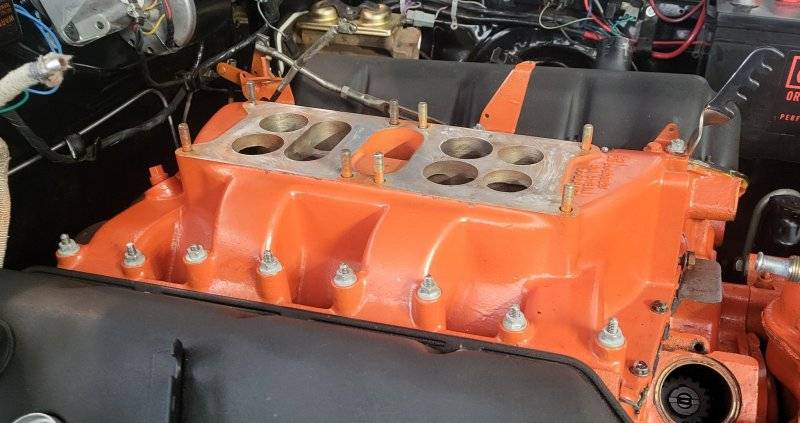

stock intakes used studs from the factory, one end was fine thread , the other 1/4 -20...
This doesn't come across as accurate if you are implying, they all were studs. They were not. As I mentioned above a combination of 10 bolts and 6 studs.
Somebody did that. Should be 10 and 6. In 68they shifted to Hex head bolts vice allen socket. Bolts were captured washer type.

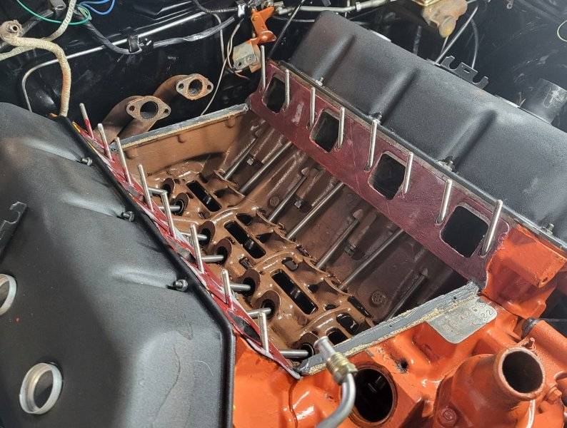

4 3” bolts go under the plugs in the rear four holes (all the bolts in the kit will be 3") 6 2-3/4” bolts go in the carb openings, 4 2-1/2” bolts go under the four plugs in the front and and 2 2-1/4” bolts go in the exposed holes.
