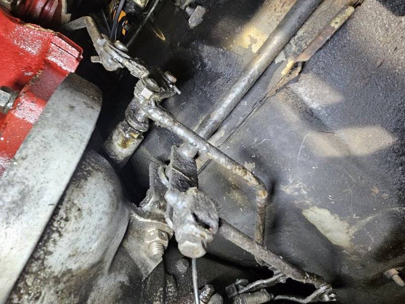

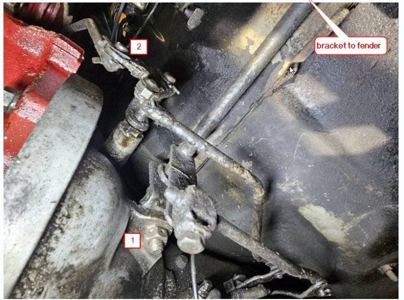

Leave the selector shaft in place. Just remove the nut holding the inner pivot support to the case and the clip retaining the shift rod to the shift lever. Don't forget to flush the cooler lines while the trans is out! I like braker cleaner followed with compressed air.

when you say nut at inner pivot, you mean #1?
And retaining clip to shift rod, you mean #2?
I thought the shaft would have to be removed because its anchored at the fender with a bracket.

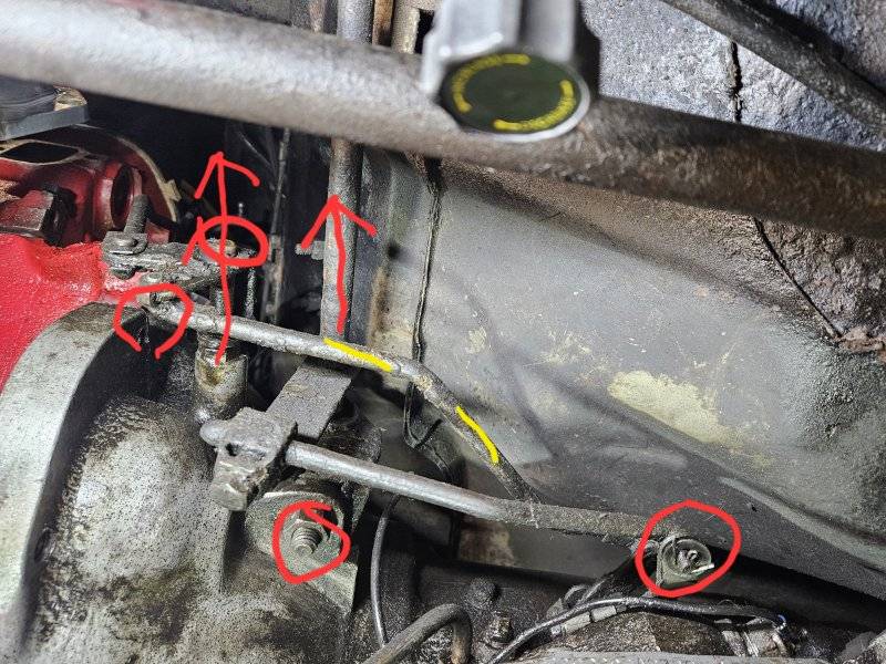

@493 Mike or @anyone
i want to be sure i understand because the FSM doesn't spell it out.
So I detach clips or nut (red circles) and leave shaft on trans to gear selector(yellow).
The assembly at each shaft (red arrow) should slide out and away from trans.?

Reference lower photo: Yes to remove lower circle hardware
Remove yellow KD rod (clips at each end).
Remove last clip at top/front of bellcrank and leave bellcrank with pivot attached.

thanks for your input. All came apart. I had to knock 50 yrs of grime off it, LOL.
Hoping to lower the trans tonight.
