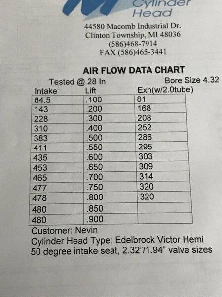

Does anyone have the flow numbers for an ootb stage V big valve head. And replacement stage v head. And edelbrock victor hemi head?? Cannot find the info anywhere.
Here’s my Vic jr’s After porting

Yeah it lists the same head with either a 2.25 intake with 1.90 exhaust valve. Or you can get the 2.42 int with 1.90 exhaust. Raised or standard ex port. But there un ported. So yes. I just wanted to see what the flow numbers were without port work.
With the bigger intake valve those heads have, I flowed it on a 4.500 to make sure the flow wasn’t impeded by the lack of a bore notch.
Plus....... they were going on a 4.500” bore 540.
I’ve only ever had a couple of stage V heads here.
The stock replacement castings “ootb” are pretty unfinished, and require a bit of work to make them even usable...... so there would never really be an “ootb” flow number.
The seats come blank, so any valid flow test is going require a valve job be done...... which then becomes part of the results.

Well that makes sense as to why i could never find the info on them. If you were building a 800ish 572 cu in hemi , which heads would you go with?.
800hp is 1.4 hp/cube. A set of the Edelbrock Victors and a nice solid roller should easily get it there.
I don’t think they’ve been available for quite a while.
Other heads can get the job done, those are just the best bang for the buck.
