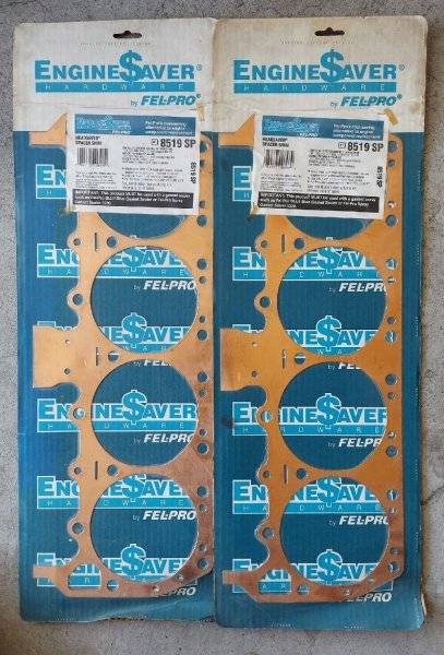

The engine had those gaskets on it when I tore it down. The shim and the .039 I was just curious if the 21 would work in place of the 20 that was on in. I mean the shim. I can find 21 but not 20.
I think they would,call an engine shop and ask.
We need pics of what you mean shim.when you get some serious measurements made, a quick call can be made to get the proper sized single gasket from cometic.
From what I guessing they slapped a stock steel gasket, and a basic felpro replacement gasket on each other. You would be hard pressed to find an engine builder that would call that a cool idea. Just saying.

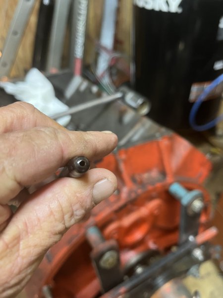

were the push rods the right ones?
The pushrods that he apparently installed were more like chevy pushrods and had oiling holes in the ends. They actual measurement was 9.250 Its printed on them

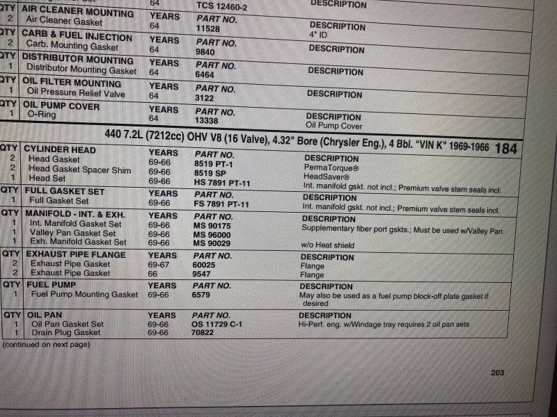

The Fel-Pro catalog lists this combo

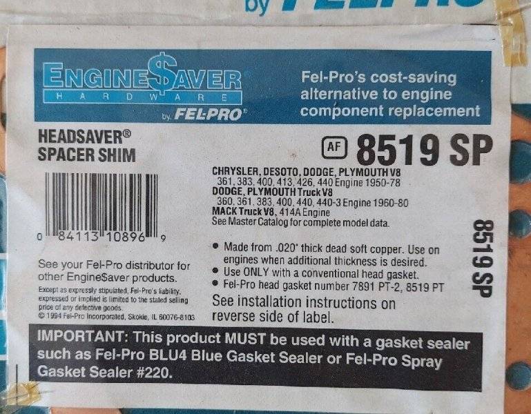

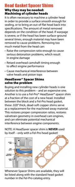

Yes you should find out if you need the extra .020” the spacer provides.
I just wanted to post a pic of the catalog page so you can see that’s what is in the catalog, and that may be the only reason they are in your motor.

Can you post a pic of this "shim"? Curious as to how this stuff all seals up together in a high compression motor :popcorn2:
Here is what I got from the felpro site.

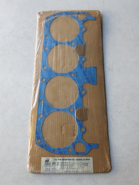

These are pictures of the actual gaskets I found on ebay

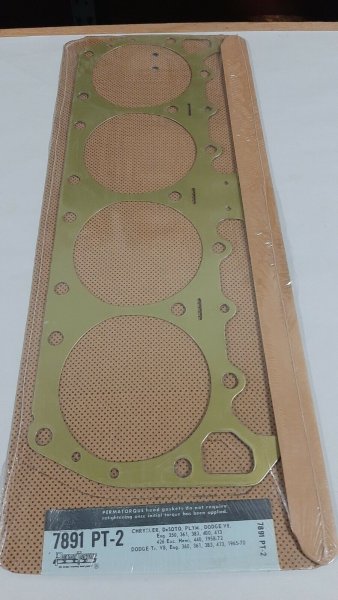

This is the 7891PT-2 They mention on the package label.

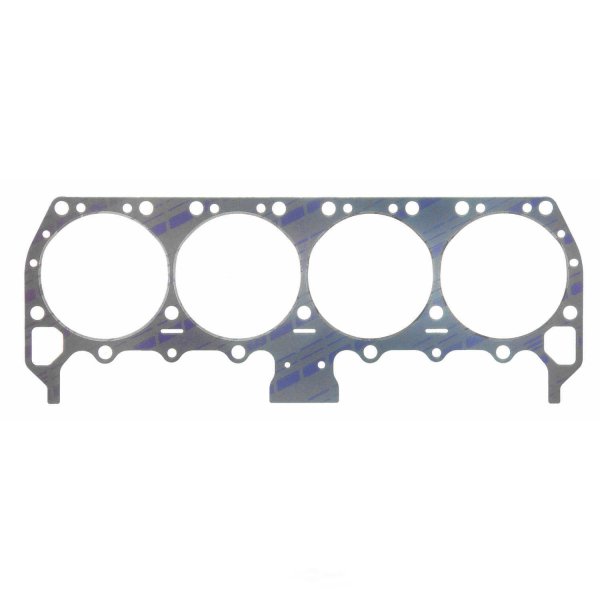

And this is the 8519PT1 they mention
Looks like the difference is the steam holes for the MH heads being there or not.
Personally, if the copper shims looked good and cleaned up well, I’d just reuse them with new gaskets.
