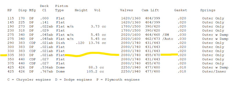

I looked up the specs that Mopar gave NHRA on 68/69 383 4 Brl.
Deck................021. ABOVE BLOCK
Gasket.............020 THICKNESS
Head................79.5 CCs
Of course, these are minimums if everything is perfect and that
is how we blueprint these engines.

This chart shows the 68 383 piston .021 above the deck, not below, for a blue printed engine. Mine was right at zero for a non-blueprinted engine. I you guys are off base on this.
