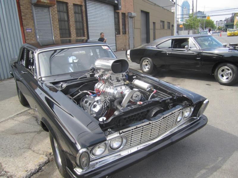

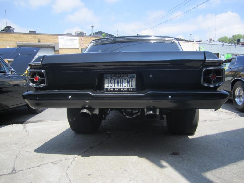

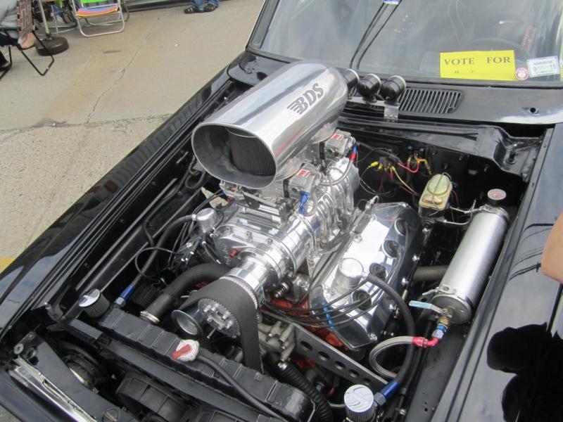

68 stock iron heads with a 1071 here:blob1:

HOLY MOLY... That is the exact build I am trying to do.... my engine builder said I would have cooling problems on the street.. got so many questions to ask you... Should have 1000 hp on the street,,,just trying to make a cool supercharged car... Can you tell me what you put in the motor,,, cam, crank, specs, type of valve train, rockers etc,,, also, what kind of trans work,,
Also,, judging by the pics,, guessing you are not using a hemi k member ? since your using the motor plate. Hope to see more pics and hear from you..
