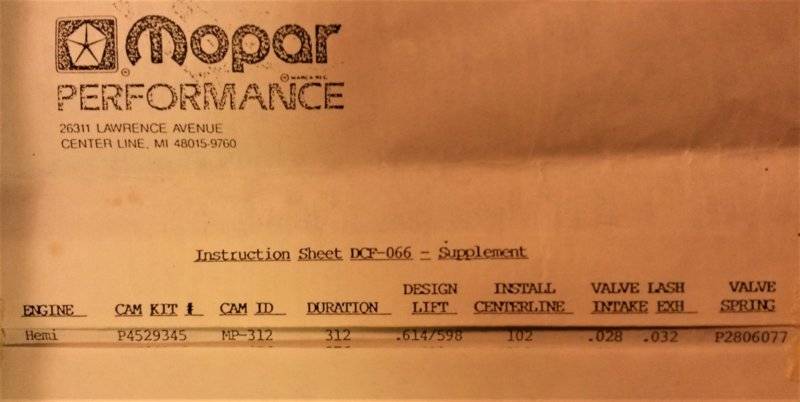

I consider this camshaft for my Nostalgia SS/B day one recreation Barracuda.
Anyone have any experience or thoughts.
Like said application is B (4-speed) 12,5, Cross Ram (stock), Holley Carbs, 2 1/8" headers, 4:88 and 10,5X29" slicks. Around 3000lbs car.
Camshaft is one of the Purple Series Cams.
What do you say? Shift point etc...

Well to me it is important. Like I say this is going to be a piece of history, and I want it to harmonies. For this particular figuration a .600 lift something camshaft is correct.
My question was if someone has any experience of this particular camshaft (since I already have it) or have any thoughts (useful) around it...
