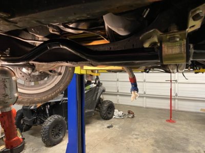

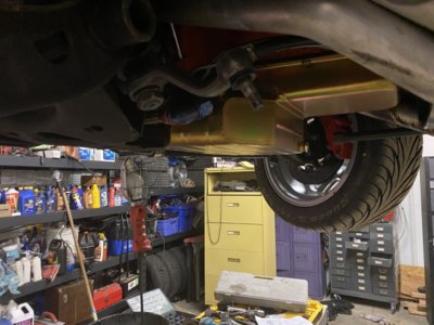

Got the Milodon road race pan mocked up, looks great. Might hang down a half inch which is good. Waiting on an AN fitting, pan gasket and a new idler arm before final bolt up.

That looks pretty good! Can’t tell in the pic but do you have a skid plate on the K?
I am planning on running a stock pan with an external pick up, initial mock up suggests it should clean the rods (stock stroke)
I didn’t test mine but with the stroker crank and the huge vintage aluminum rods I doubt it would have cleared. Not thrilled about the aluminum rods but I’ll address that in the future.
