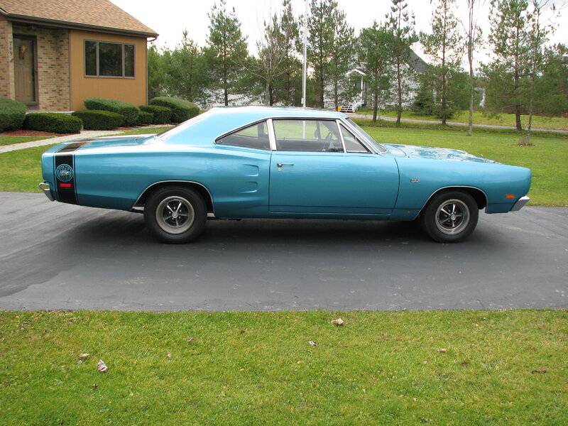

This was my Bee after I put the MP Hemi springs on. I should have never sold that car...
