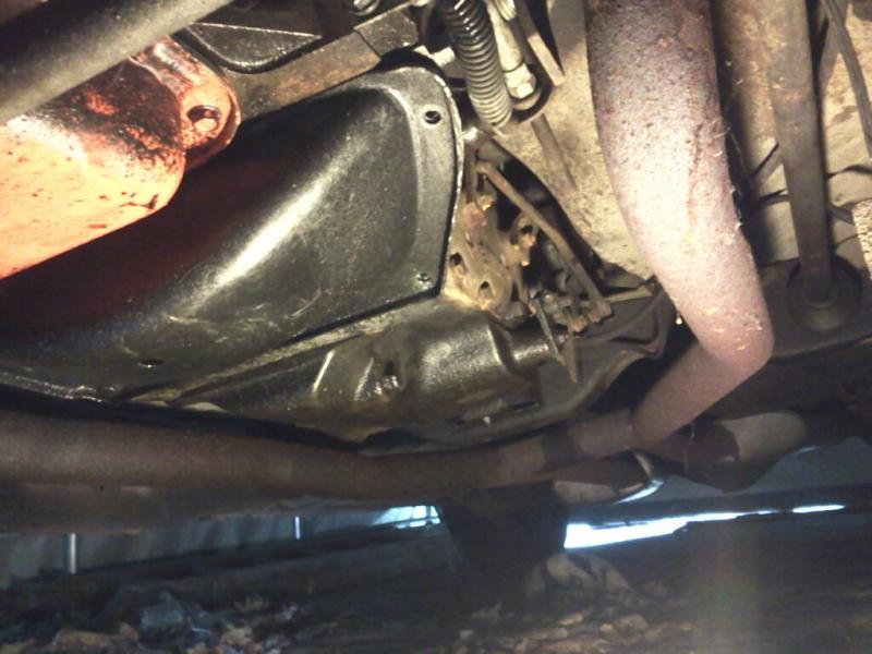

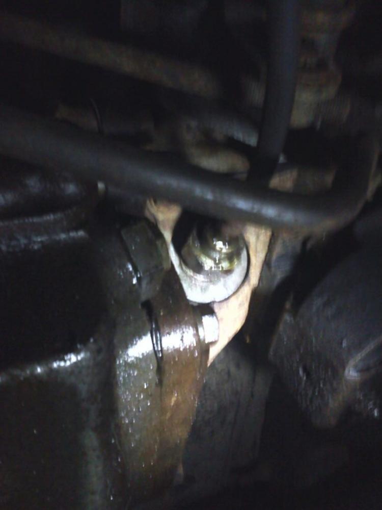

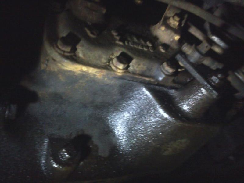

Well you're right thanks! Being under there has led to some other concerns I hope you can help with. I will post pictures. In the 1st picture you'll see the housing where the shift linkage goes is pretty wet on the bottom. Right to the rear of this housing is a fitting as seen in the 2nd picture that appears to be leaking. It has a hose that I traced to the fire wall just drivers side of the steering column. I can't see where it goes once inside can you tell me where and what it's for? The housing from the 1st picture looks like it has a drain plug lower drivers side and a fill / level plug upper passenger side. I assume I should undo the fill plug and top up or should I drain completely and replace? And what's the best stuff to put in there? Any recommendations for how to stop that leak? Lastly in the 3rd picture there's a bell housing between the linkage and the oil pan that's missing 2 bolts. Is this just protective there isn't any fluid in there to leak is there? Sorry if I sound like a dope and thanks for any help!

2nd pic is your speedometer gear and cable. You can obtain new replacement 0-rings.
I can't quite make out what Im looking at in your last pic. Maybe someone else can help.
Wow thanks I would never have guessed speedo cable that's good to know. So there's fluid in there? Clutch fluid? That 3rd pic I think is a cover off the bottom for the clutch would be my guess. It's right in front of that linkage for the shifter.

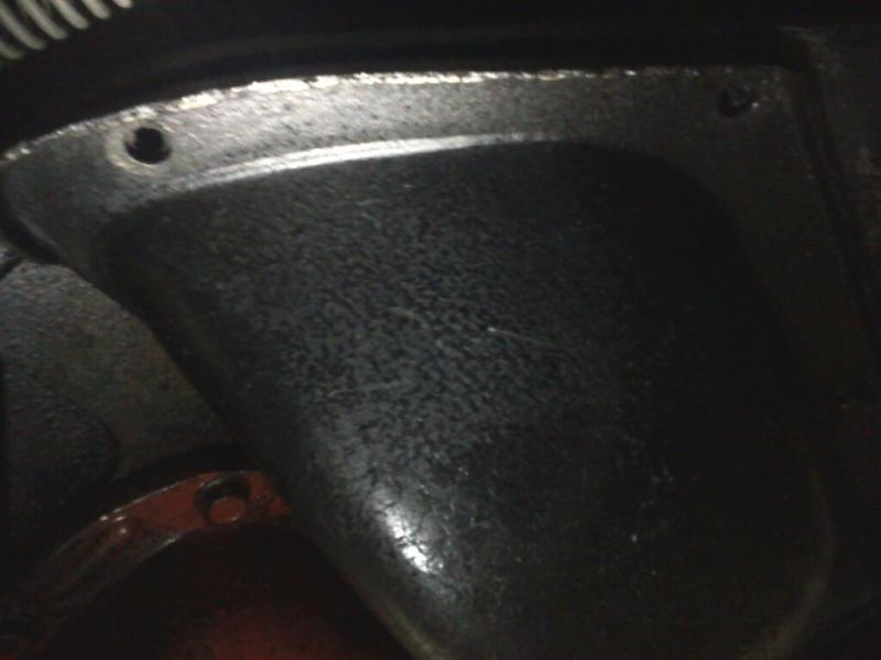

Here's another pic that shows that cover better

The bolts are missing from the inspection cover/debris shield. Or are they broken off in the bellhousing? I recommend a new shifter assy. Or have yours rebuilt. It jammed once, it will again. Out on the road somewhere isn't ideal. I run synchroshift in mine. I think factory fill is gear oil. Anything is better than nothing. If you are not playing Ronnie Sox I would use gear oil
ok thanks and no nothing broke in the bellhousing they must have just worked out I'm certain they were there before
